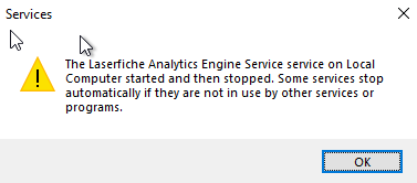

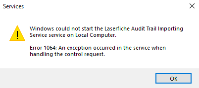

We've been testing out applying the group managed service accounts to the LF services in our customer's dev environment. They just tried it on the Audit Trail related services first. After changing each from the local account to the gMSA, they restarted each service. The two services indicated by the arrows produced the errors below. The other two started up just fine.
When trying to start Audit Trail Charts Component Engine:
When trying to start Audit Trail Importing Service:

Those error messages in your screenshot should have corresponding Windows Event Log entries with additional details. Depending on where exactly they failed, the relevant log entries could be in the Windows Application, Windows System, or Laserfiche Audit Trail (names approximate) event channels.
The most common reason for service start failures like what you're showing are port listener conflicts or permissions issues where the new service identity doesn't have rights to listen on the port it needs to. That's not a gMSA-specific issue and can happen with normal AD accounts as well. An easy way to sanity check that is to temporarily put the gMSA in the local Administrators group (which gives it all the port listening rights) and see if the services start. If they do, you know you have a permissions/URL ACL issue and need to pinpoint where. For a general example of how you fix that, see this Note in Laserfiche Forms Notification Setup documentation:
