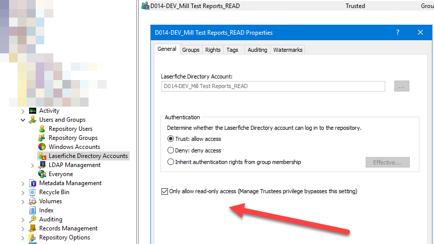

My guess is the checkbox for "only allow read-only access". If a user is a member of any groups with this box, they'll only have read-only access.

Well we spent an hour making sure this is not the case. The order I check is to see if the user is read only, then to see if any groups they are a member of are read only, then to see if they have a participant license.
Then we created a new directory server users off domain without adding to any groups and they were also read only.
So it appears if you create additional repositories, all users are read only regardless of this checkbox being checked.
