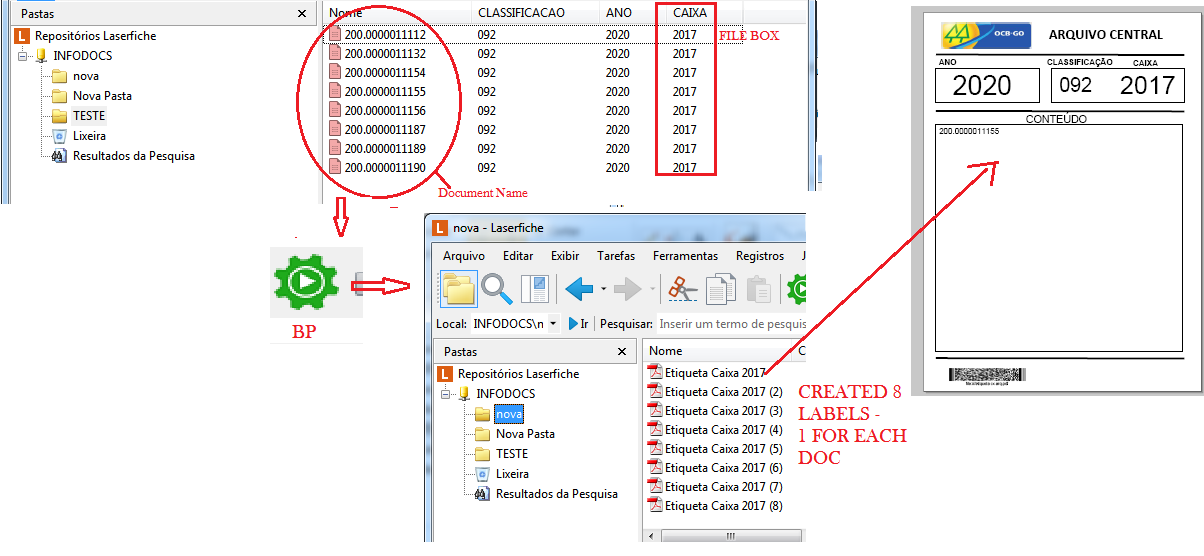

I created this business process to generate a label to be stuck in a file box.
In this process the 'content' field must accumulate the 'document name' values from all documents that have the same value for the '#box' field and the associated 'box tag'.
Next, a PDF document is filled with the values stored in the tokens
THE PROBLEM:
It turns out that it generates a PDF for each "content" token instead of creating a single PDF with all the values of the "content" field
Can you help me with this problem?

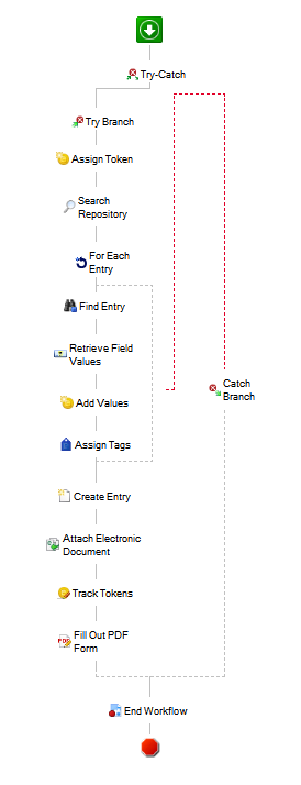

Down the workflow:
Create PDF Box Label:
Workflow Details:
Connection Profiles:
  •  INFODOCS (pc005; INFODOCS; wf)
  • label cx file.pdf
Corporate Process Options:
    • Can be booted on Laserfiche clients connected to 'INFODOCS'
    • Can be viewed on Laserfiche clients connected to 'INFODOCS'
    • Status started: Running
    • Status Completed: Completed
    • Status Canceled: Terminated
Try-Catch:
        Attempt { }
        Capture (Exception)
                Try Branch:
                        Assign Token:
                        Create the following tokens:
                        • %(year)
                        • %(box)
                        • %(Content) (multiple-value)
                        • %(Rate)
                        Search Repository:
                        Search Query:
                                ({LF:Tags="box"})
                        If a search is a shortcut, keep it as a shortcut
                        Not case sensitive. Sensitive to accent:
                        Return: All results
                        Additional properties:
                        Properties of field options:
                        Sorting properties:
                        For Each Entry:
                        Iterate through the entries in:
                        (Search Repository::Output Entries)
                                Find Entry:
                                Find the entry with the ID: %(ForEachEntry_CurrentEntry_ID)
                                Retrieve Field Values:
                                Entry: (For Each Entry::Current Entry)
                                Field values ​​to retrieve:
                                • YEAR
                                • BOX
                                • CLASSIFICATION
                                Add Values:
                                Modify the following tokens:
                                • %(year) = %(RetrieveFieldValues_year)
                                • %(box) = %(RetrieveFieldValues_box)
                                • %(Content): Append %(ForEachEntry_CurrentEntry_Name) (multiple-value)
                                Assign Tags:
                                Remove Tags: box
                        Create Entry:
                        Name: Box Label %(box)
                        Type: Document
                        Volume: <Use default volume from parent folder>
                        Destination: \new
                        Attach Electronic Document:
                        Attach cx arq tag to (Create Entry::OutputEntry)
                        Source: Server Attachment
                        If an electronic document already exists: Replace the electronic document and do not record a warning
                        Track Tokens:
                        Report the value of the following tokens:
                        • Content
                        Fill Out PDF Form:
                        PDF: (Create Entry::OutputEntry)
                        Master Form: cx file label
                        Merge field content with image
                        Fields to be filled:
                        • YEAR = %(RetrieveFieldValues_YEAR)
                        • Rating = %(RetrieveFieldValues_CLASSIFICATION)
                        • Cash = %(RetrieveFieldValues_CAIXA)
                        • CONTENT = %(Entry Name)
                Catch Branch:
                Capture (Exception)
        End Workflow:
        Complete current and primary workflows

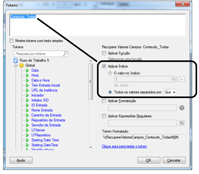

Your summary says: CONTENT = %(Entry Name)
So the content field gets set to the name of the document that started this workflow. You want to set it to the Content token you created and format the token to show all values delimited by a new line.

I was change ... but we don´t have success. The BP create 8 label. One for each doc
I need one label doc (etiqueta cx 2017 doc) for the 8 LF docs

hi Miruna .. We solved this issue with this:
In the PDF tokes ... we choose the "Token Dialog" and mark how show below
replied on June 24, 2021
