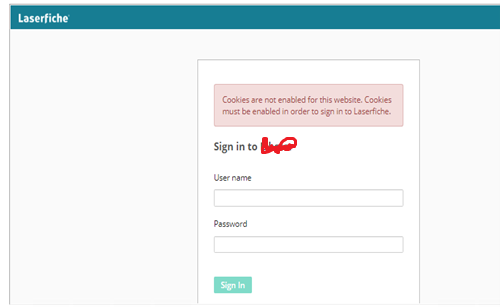

Hello,
We have a customer who just update their Chrome Browser to V91 and now they are getting the Cookies are not enabled for this website.
We saw this issue with Chrome 80 and updating customers to WC 10.4.2 Update 1 resolved this issue (KB Link below).
https://support.laserfiche.com/kb/1014094/additional-configuration-for-chrome-80
I updated this customer to WC 10.4.2.347 (Update 3) and they are still hitting this issue.
We also knew that you could go to Chrome:Flags settings and disable SameSite Cookies, but with the update to V91, Google removed that option:
https://support.google.com/chrome/thread/111426858/after-version-91-update-how-do-you-disable-samesite-cookie-options?hl=en
Anyone else having this problem with Chrome V91 and WC 10.4.2??

I have a client that is on the latest update of Web Client 11, they have it configured to use TLS/SSL, and when accessing Web Client it has a valid certificate. They are still getting the message "Cookies are not enabled for this website." message when trying to login to Web access from Chrome/Edge. If the client logs into web client first, then accesses Laserfiche through the iFrame, there are no error messages. I've been making adjustments to the web.config to no avail. Are there any new suggestions I can try to get this working without that error message?
replied on May 10, 2023
The Chrome dev tools will often tell you why it is handling the cookie the way it is, which should give you information about what you need to change.
