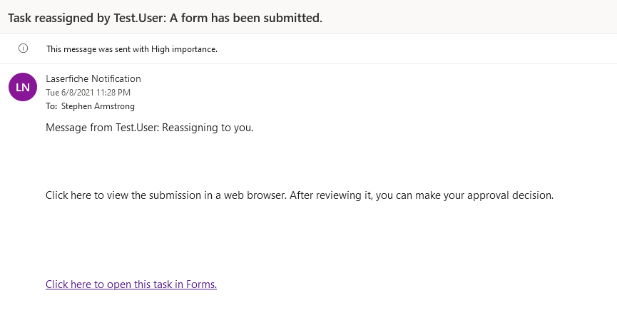

replied on June 8, 2021 Show version history

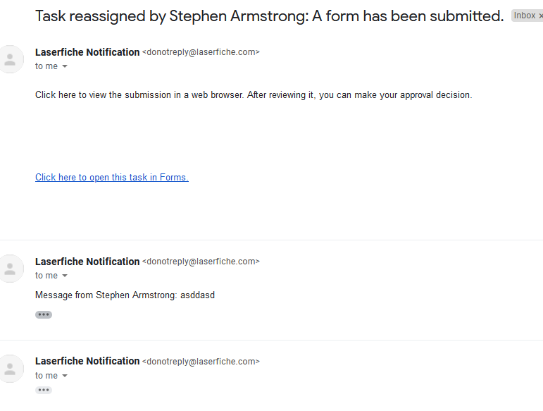

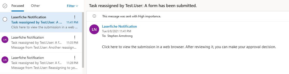

That's weird. I did some reassigning between a test user and myself twice again (on the same process instance) and got email updates. I even tested without leaving a comment to see if that had any effect. Received two email notifications:
I also checked the test account email address as well and got the notifications:
