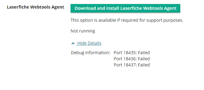

I uninstalled the Webtools agent and re-installed it but still have this:
replied on June 7, 2021
It sounds like something else is using those ports, so WebTools Agent fails to get hold of one.

This is on my laptop - I've created incoming & outgoing rules on the Windows firewall.  Do I need to create a rule on my Web Client server for incoming or incoming and outgoing?  Are these TCP ports or UDP?
replied on June 8, 2021
You shouldn't need to open up ports in the firewall, that communication is all local to the machine where the browser is.
It's probably best that you get a hold of your reseller and open a support case so we can properly investigate it.
