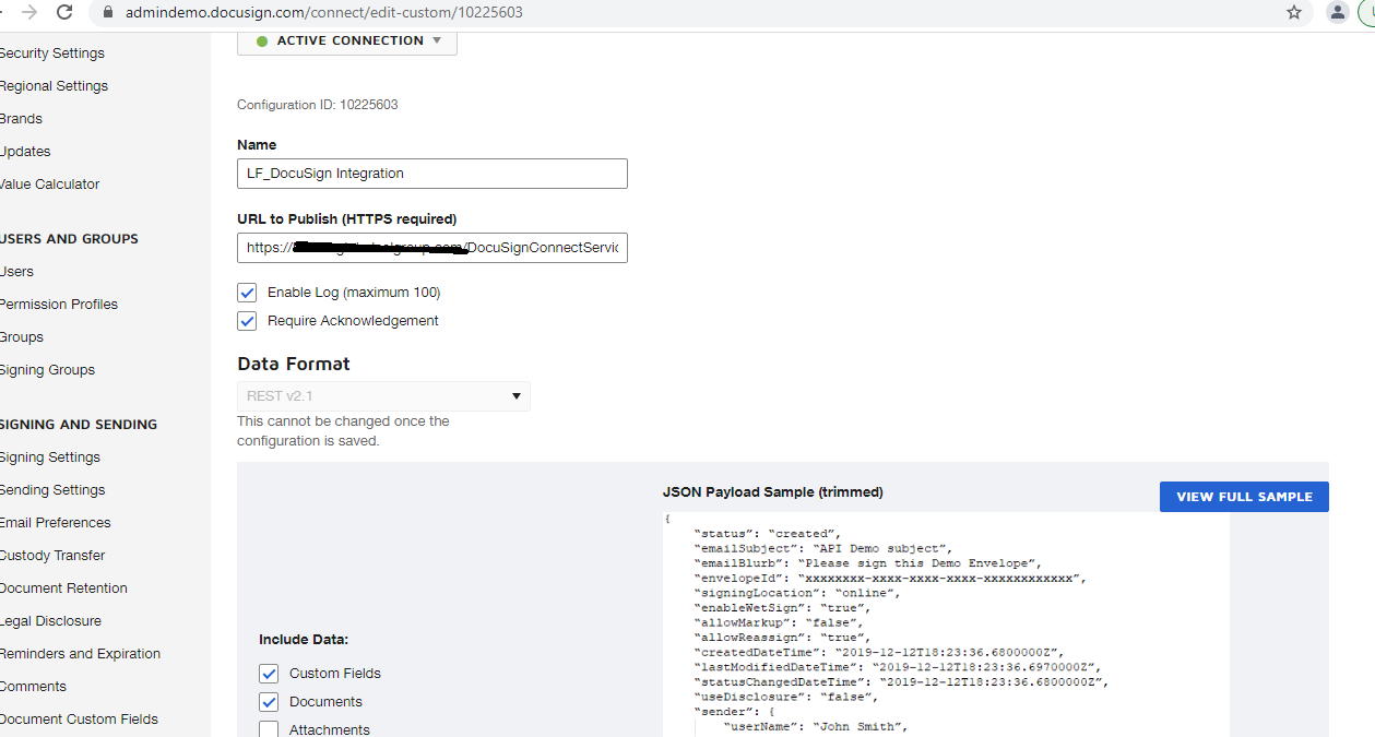

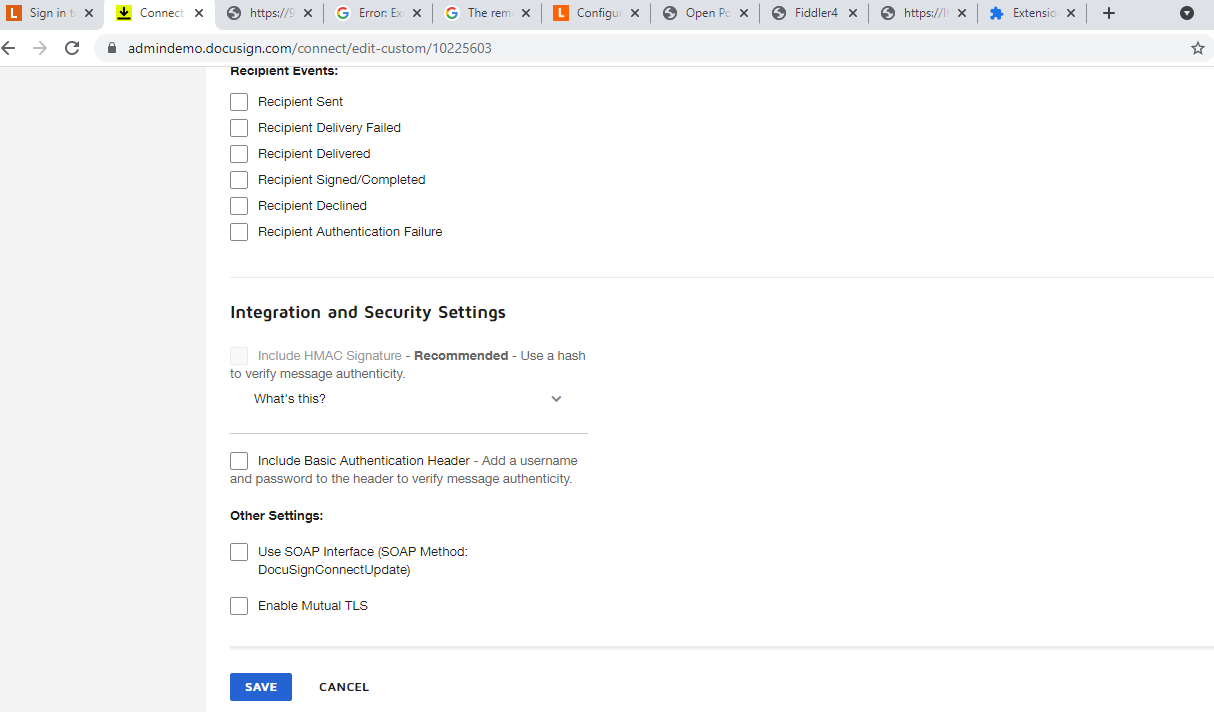

I am trying to integrate Docusign with Laserfiche.  Using my current setup , I am able to connect Laserfiche client with docusign.  I am able to assign docusign template to Laserfiche document for signature.
My problem is now when I want to import signed document back again to my Laserfiche repository with document version. I have completed all necessary setup, but within DocuSign after service request , it shows 500 internal server error.
I am not able to find that whether its problem with Laserfiche side or docusign side.

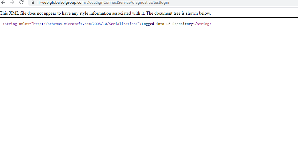

I have tested below link and its works fine and shows message that "Logged into LF Repository"
https://servername/DocuSignConnectService/diagnostics/testlogin
I am using below link to connect from docusign to my server.
https://servername/DocuSignConnectService/receivepdf

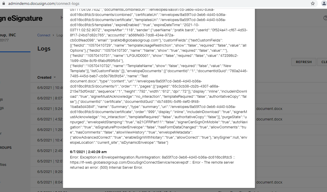

On docusign , When i checked log it shows "500 Internal server error".
I am attaching settings in docusign ( setting.txt ) with IIS and also configuration in docusign for connection ( docusign-1, docusign-2 and docusign-3)  ,Error within docusign ( doscusign error)

replied on June 8, 2021 Show version history
The problem is that the connection is using the "REST" data format and not the "Legacy" one (see your first screenshot). DocuSign recently made this change in the UI and switched the default. We have updated our documentation to cover this. You can't change this property, you'll need to delete this connection and make another. We do have plans to make the connector understand both, but there isn't an ETA on that yet.

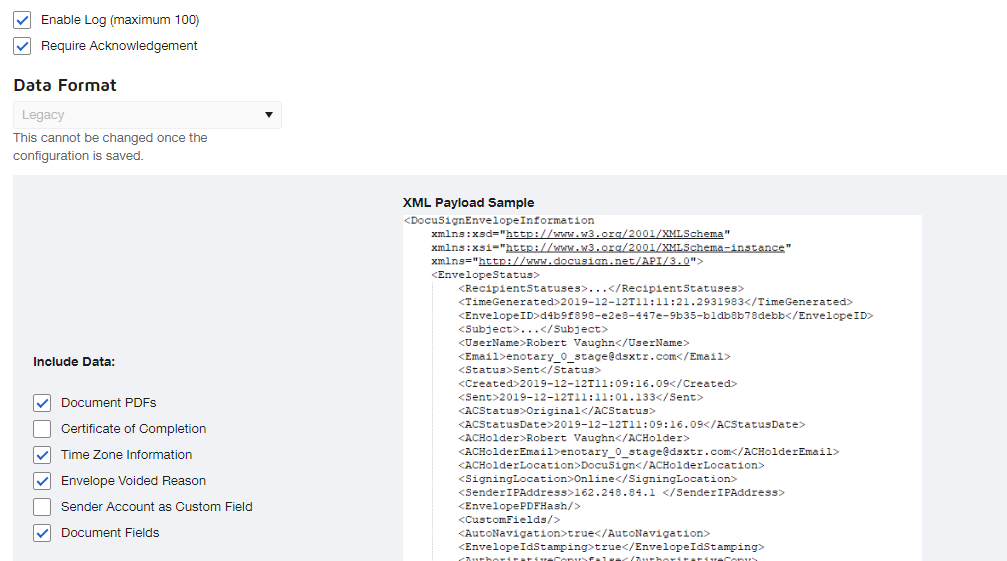

replied on June 9, 2021
Yes , problem with "Rest" data format. "Legacy" data format setting solved problem. ( see attached screenshot )
I have deleted old connection and created new connection with "Legacy" data format and everything working fine as per requirement.

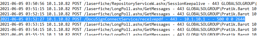

replied on June 7, 2021
Also  I do not see any error message on IIS log. In IIS log , i am able to see below things.
Also See that web.config within docusign web directory with IIS.
Thanks,
Pratik Barot

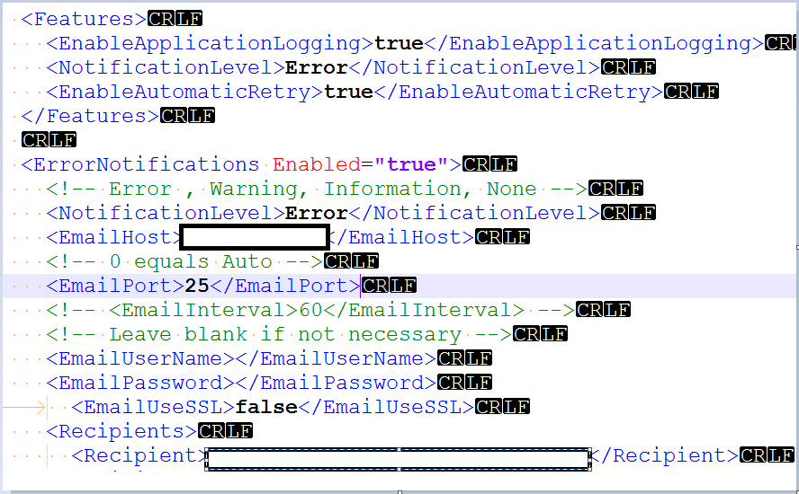

Did you enable logging feature in Docusign Connect Service config file ?
If not, enable it and it will tell you the exact error (you can also enable email error notification and receive the error by email)
To enable logging feature, locate features section in config.xml file as shown in screenshot below :
