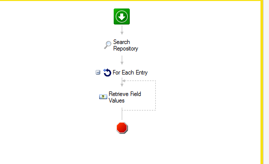

Hi,
If you are looking for several documents and want to process each of them. In your workflow, you have to iterate over the collection of documents.

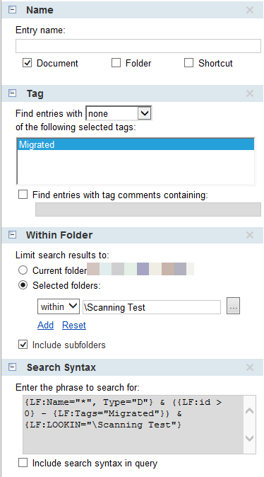

What's the search query if we need to do it by folder?
replied on June 28, 2021
You would just add "Within Folder" to your search. Here's an example for including a folder named Scanning Test:
