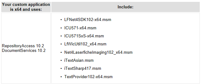

If I'm understanding correctly, on a "clean" machine your application does not find all of its dependencies. This would have been true before LF11 as well. Assuming the program is x64, can you confirm you're including all of the following per the SDK 10.2 documentation?:
Installing the Laserfiche SDK 10.2/10.4 Runtime installs ALL the relevant Laserfiche 10.2/10.4 libraries to the GAC. If you don't find a merge module issue that resolving addresses the TextExtractor error, I recommend making installing the SDK 10.2/10.4 Runtime beforehand part of your deployment procedure for the time being.

Thank you for your assistance. Yes, our application is 64-bit and includes all of the merge modules required to use RepositoryAccess 10.2 and DocumentServices 10.2, according to the documentation you referenced. We did not experience this symptom with Laserfiche 10.x installations or Laserfiche 10 to 11 upgrades, only now with clean installations of Laserfiche 11.
