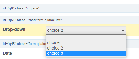

Anyone notice they are able to change read only select type fields in this specific version of forms?
You can clearly see it is read-only by the background color, but I can select any select type filed and pick a new value.

I am setting to read only using this line of script. Field rules do not yet support read/write in the modification options, I believe script is the only way to do it and I have been doing this for years without issue.
$('.className select').attr('readonly',true);
I just tested changing it from the task where it is read-only, and on the next task it is changed in the history and in the current forms variables.
