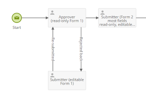

You should have a message start event followed by a user task assigned to the approver. If approved, go to another user task assigned back to the initiator with a new form selected. That new form should be a copy of the initial form with an additional signature field.
So the message start event, approver task, and submitter task at the bottom should all be the initial Form 1. The user task to the right should be Form 2 with all the same fields set to read-only and then a signature field that's editable at the bottom.
