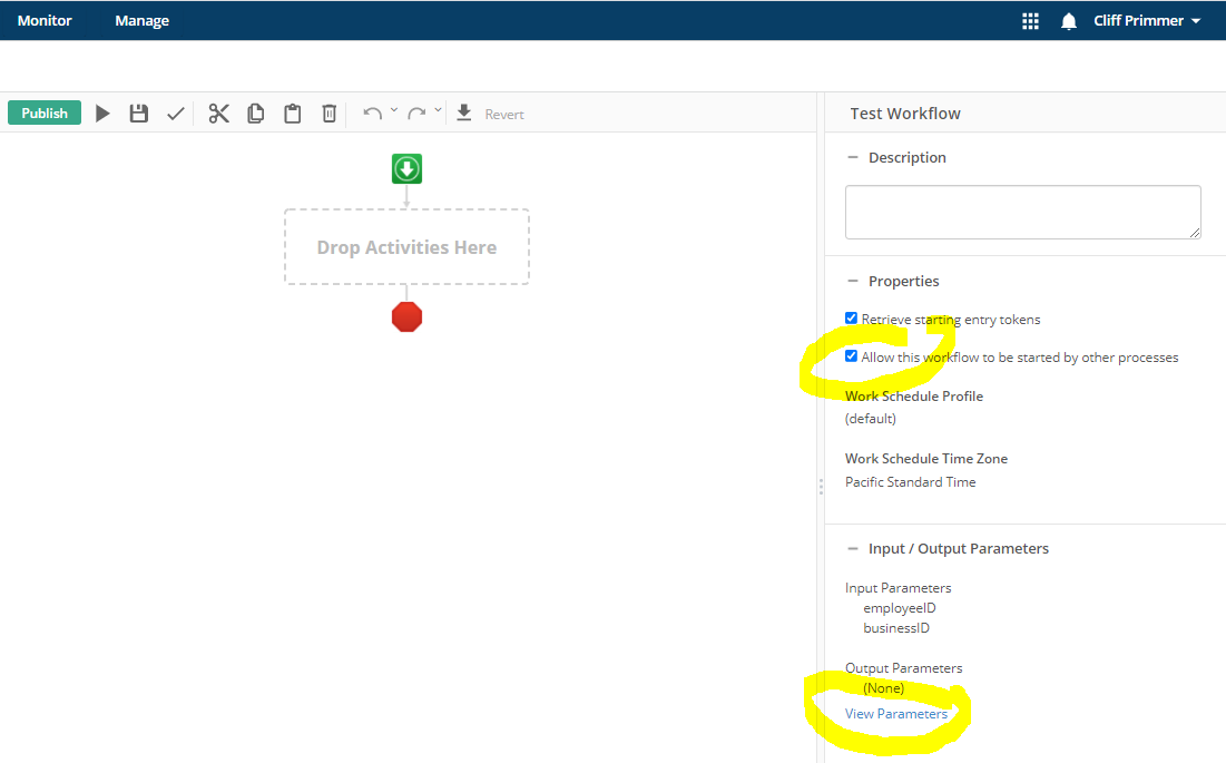

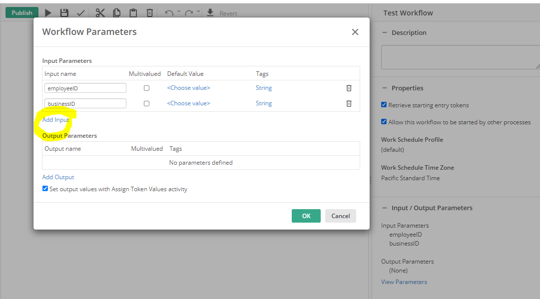

It is a bit different in Cloud.  I would start with the workflow.  First make sure you check the 'Allow this workflow to be started by other processes' in the workflow properties.
You will configure the workflow input parameters here as well.  Click on the 'View Parameters' link to open the parameter dialog.
Click on the 'Add Input' link to begin adding input parameters.  In my example I an passing an EmployeeID and BusinessID value to the workflow from my form

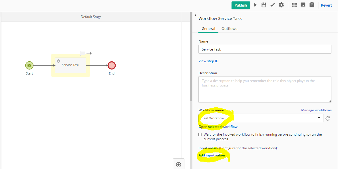

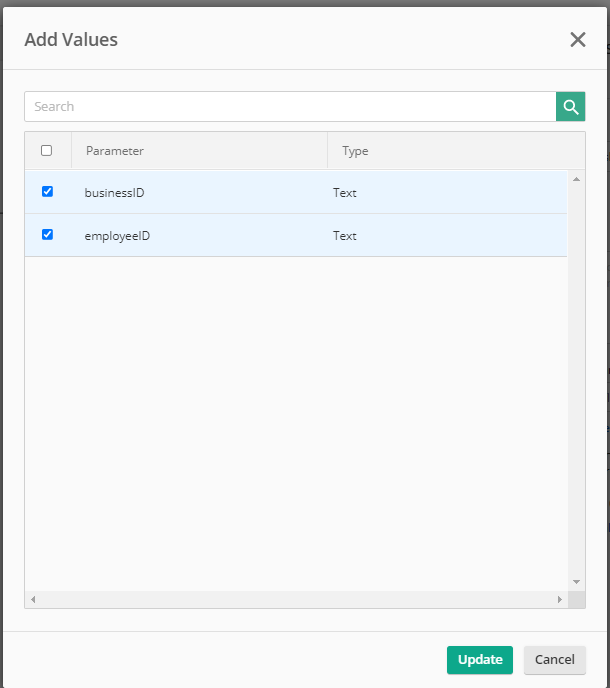

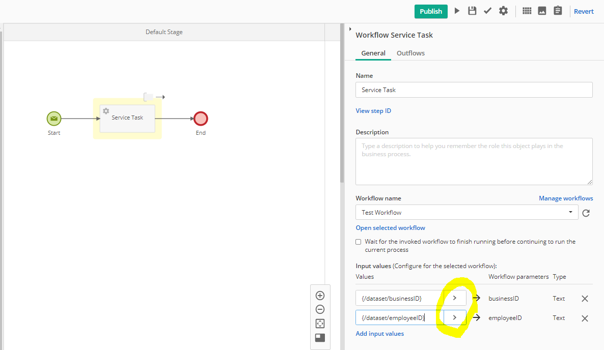

Publish your workflow then return to your forms process and add a workflow Service Task to the process.  In the workflow service task select your newly published workflow in the 'Workflow Name' dropdown, then click on the 'Add Input Values' link to open the input parameters dialog and select all of the input parameters for your workflow
Back in the workflow service task configuration click on the '>' button to assign the field values from your form to the workflow input parameters.

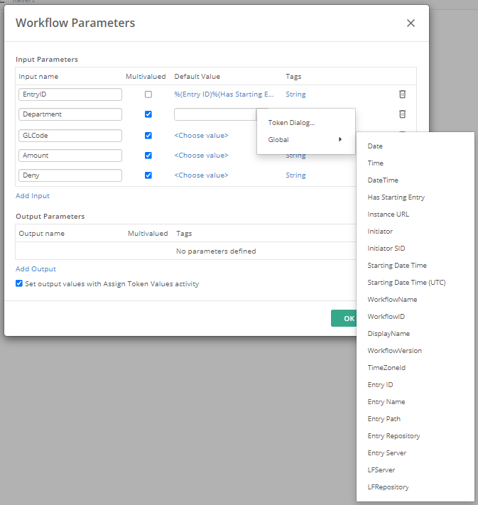

Thank you! I now see how to connect the values to eachother, and that is working. However, in my workflow parameters, for the default values, I am only seeing global values:

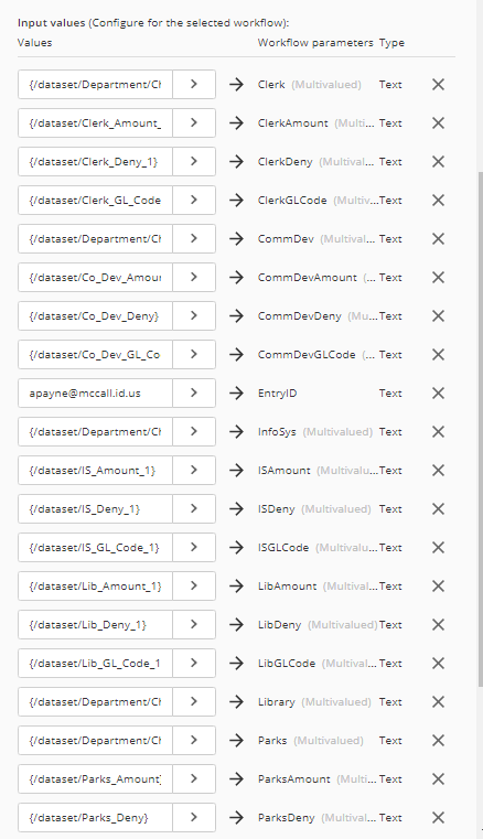

I think this might be because the fields I am trying to pass on are multivalue fields. So, in the workflow service task for my business process I selected multiple tokens separated by commas. My guess is this is not the way to do it. Do I need to remove the commas? Create an input value for each individual token? Any ideas?

Unless I am missing something you wouldn't be setting default values for the workflow.  The values that the workflow will use will all come from the form or forms process itself and be set in the workflow Service Task as input parameters for the workflow.
Does that make sense (or can you provide additional feedback on why you would want to set a default value versus setting the values from the forms process)?
I also see that you have a workflow input parameter named 'EntryID'.  What is your  thought process behind that parameter?

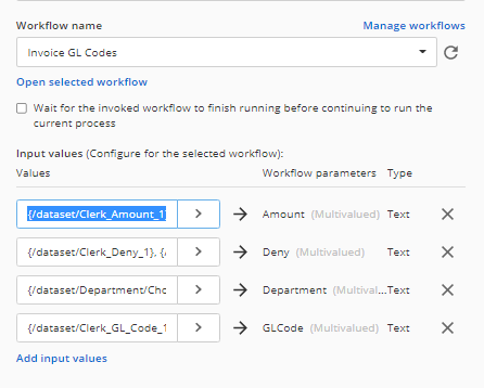

So..... the business process is actually started from the workflow. I am passing on the entry id because we are imbedding the document that starts the workflow in an iframe on the form. The business process splits the form between multiple departments and then brings the information requested of them into one combined form. The part I am stuck on is passing the variables for information provided by each department back to the workflow so I can use them to populate the template metadata. So there is some back and forth. The information I am trying to pass on is the departments, GL codes and amount of money they are approving. So in the business process service task I created department, GL codes, amount, etc., then put all of the variables pertaining to that category in the input values separated by a comma, like so {/dataset/Clerk_Amount_1}, {/dataset/Co_Dev_Amount}, {/dataset/IS_Amount_1}, {/dataset/Lib_Amount_1}, {/dataset/Parks_Amount}, {/dataset/PW_Amount_1}. I haven't tried this before with multivalue fields. It does not look like they are showing up as options in the workflow default values so I am wondering if I need to create an input value for each variable instead of lumping them all into one?

So my thought would be that yes, you would have to create an input parameter for each form variable instead of trying to pass multiple values in a single parameter.

On the business process side I added all of the token values for the input values.
However, in my workflow I still can only see the Global values when I go to set the default value. Any ideas as to why the token values are not transferring from the business process back to the workflow?

Like Cliff was saying, I'm not sure we're getting what you're trying to do. Forms will set the values for the input parameters when it starts the workflow. You already set those on the Forms side, what are you trying to accomplish with the default values on the WF side?

Forms can't pass data to a running workflow instance. It can only start a new one and pass parameter values. Workflow does not have access to Forms variables, the variable values are passed into the the workflow input parameters at run time. If you set up the WF Service task on the business process side, you're done.
Default values for input parameters are meant for the case where whatever starts this workflow does not pass any values.

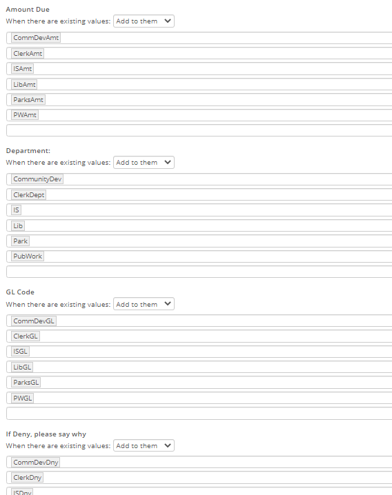

I kind of thought so, so I went ahead and did that. Now I am assigning field values for the template.

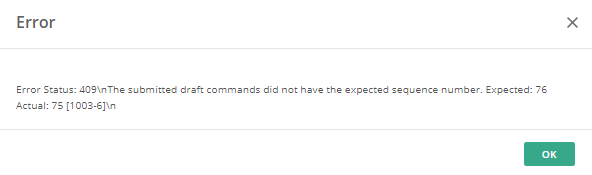

When I go to save I am receiving this error message.
Not sure what that is about.
