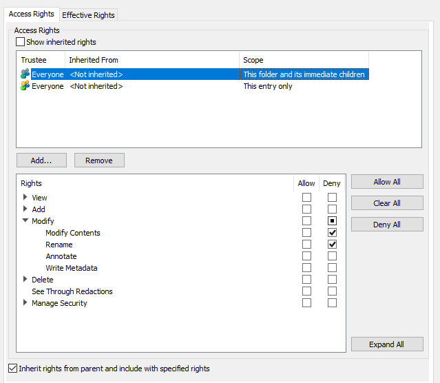

We have this recurring problem where staff members move folders into other folders.
As near as I can tell, they are moving their mouse when the double-click, so it ends up being a click-drag-click move instead of a double-click move.
The problem is, multiple times, this has impacted some of the most important parts of our repository - things that have a lot of automation and workflows impacting them - so it causes tons of grief cleaning them up.
I've been trying to set-up permissions to prevent this from happening, but I just can't seem to make it work.
I've got permissions on the folder set for the Everyone group (which all staff have) to deny "Modify Contents" and "Rename" for this entry and its immediate children.  Yet they are still able to drag this whole folder into another folder.
Has anyone encountered a similar issue and know how to prevent this from occurring?
Thank you.

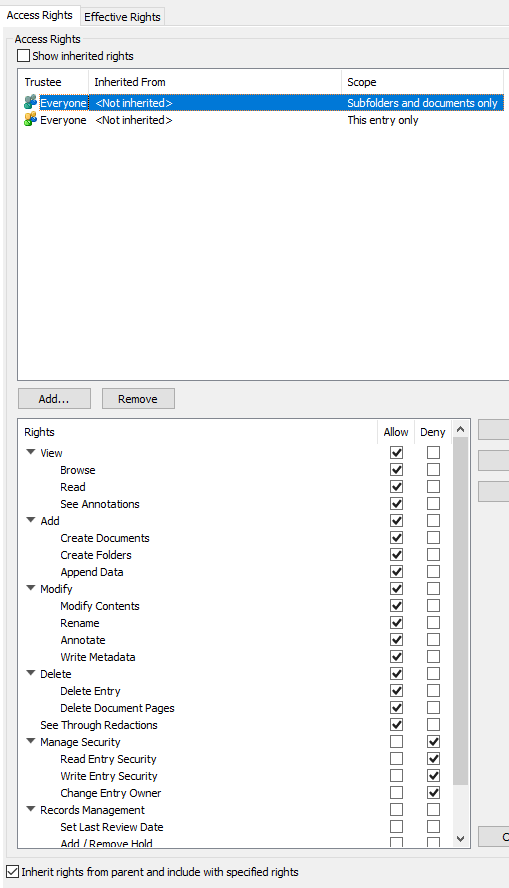

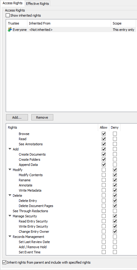

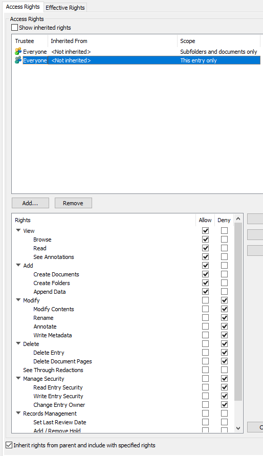

replied on May 27, 2021
I tried this to isolate a single folder, maybe it's redundant, maybe I have some odd permissions set that differ from yours. Everyone group has all folder, sub, docs set with full at the root. The first example is the folder 1 (this entry only) higher than the isolated folder. The second 2 examples at the folder being isolated. I also wasn't satisfied with with all of the folders being locked, I wanted just the one. I'm not sure how this worked, but it does for me. Is there something that would make this better and I'm just missing it? Thank you for your contributions and consideration.
replied on May 21, 2021
replied on May 21, 2021 Show version history
That's basically it - but I can't figure out why it isn't working for me - which is why I did a new post instead.
The only real difference I see is that I have allowed the ability to annotate and do metadata, while denying the ability to modify contents and rename.
I would assume that the ability to move a folder is related to "Modify Contents", which I've denied - but that doesn't seem to be the case.

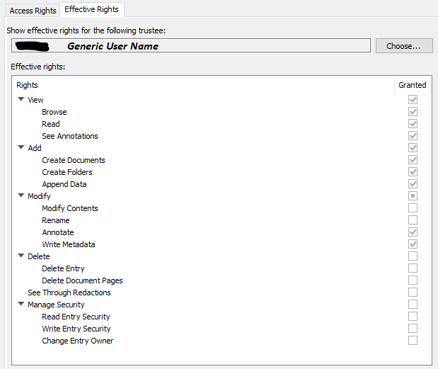

I tried with a different folder (one that wouldn't cause issues to test with), denying all of the Modify rights for the Everyone group, and it still let me drag the folder into another folder, despite not having any modify permissions.
