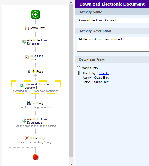

replied on May 21, 2021 • Show version history
Yup you got it!
You'll most likely still need to create a new entry to fill in the PDF, but the change would be that in a "redo" situation you would yank out the PDF, transfer it over, then dispose of the unneeded document afterward.
Here's a very basic example,
  1. You create a new (and separate) entry no matter what
  2. You add the PDF
  3. You fill out the PDF
  4. IF it is a Redo
    1. Download the PDF with the Create Entry output as your source
    2. Find your "existing" entry for the redo
    3. Attach the filled out PDF to the original (use the download activity as the source)
    4. Dispose of the "working" entry
The end result is only one tracked change on the original document because you did all the intermediate changes on the other entry and just added a "finished" PDF.

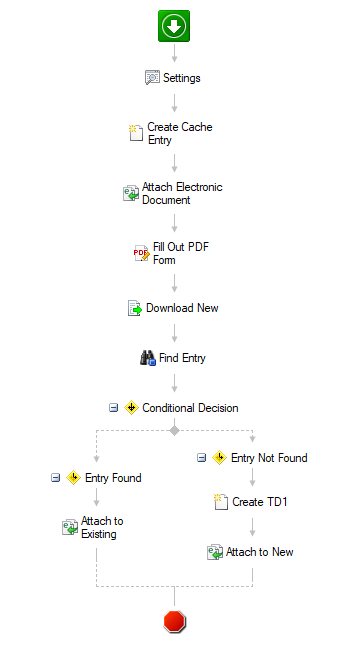

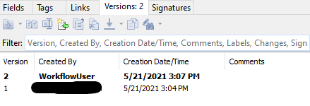

This is a better version with commenting  Tested with two executions that produced two versions in the target location with no intermediate versions.
Ta Da!  Thank you again.

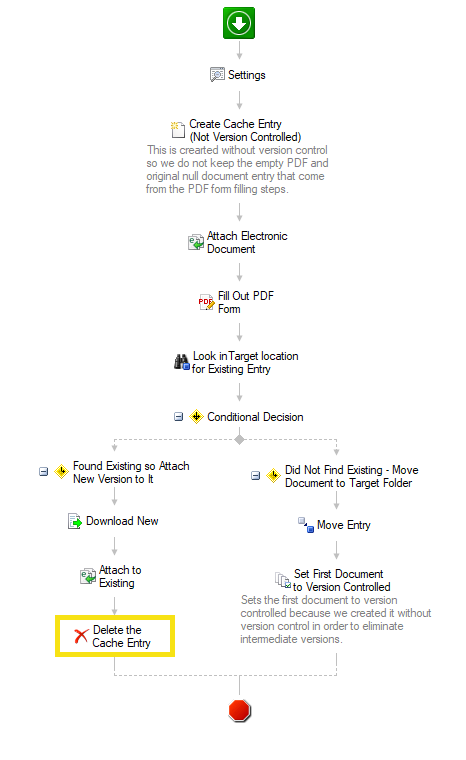

This did it fine.  Thank you for persisting with your help!!
That should do the trick, just make sure to clean up the temp/cache document afterward if you don't want a bunch of leftover documents hanging around.
I'd still recommend having at least one "processing" folder where versioning is not enabled by default; this way you can create new documents in workflow and still decide when it becomes the "first" version.
Depending on your volume, the approach you put together should be fine, but you'll probably run into this more than once so knowing how to control that initial version when necessary could really help with efficiency and provide more control over the versioning process.
I had users with similar concerns about multiple versions, so I actually ended up with an SDK script that updates metadata, pages, and the attached PDF as part of one change/version avoid similar issues/confusion.
My improved and commented approach is replied below.
