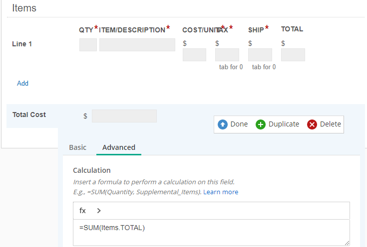

I am trying to create a form that was in the old designer, in the new designer, but the same calculation that was working, doesn't seem to do anything. It is just a simple SUM function.
This is the from the classic form and it works.

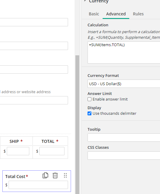

And on the new one same thing, even re-created the rule to see if the syntax has changed
My other complex calculation is working straight from the other form, but this super simple SUM function doesn't appear to be working at all.
No calculation error either.
