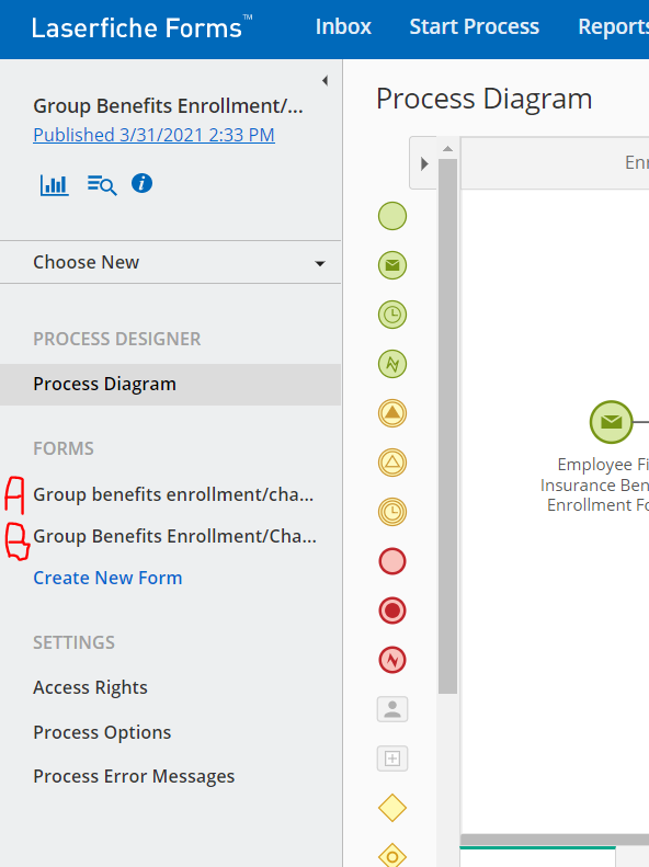

I'm a little green to Workflow and am unsure if I need one. I've built a form that works like this:
  1. Form A is submitted by employee.
  2. Form A is reviewed by Payroll.
  3. Once Payroll approves, Payroll is to complete Form B.
  4. Form A and B save into Laserfiche Repository.
Both forms are built within the same process (labeled as A and B in the attachment). My process diagram is also attached.
PROBLEM: When I try to test the process, I am able to approve the form, but then the second form comes to me as a task and is not open for editing (it's all greyed out).
Do I need a workflow to trigger the second form, or should I be using a different event in the process diagram?
Form A and B.PNG (51.55 KB)

replied on May 17, 2021
Can you provide a screenshot of the task in your inbox and the open task window? It could help narrow down what is going on.
Yep, below are the screenshot for the email that I get, and what it looks like when I click on the link:
