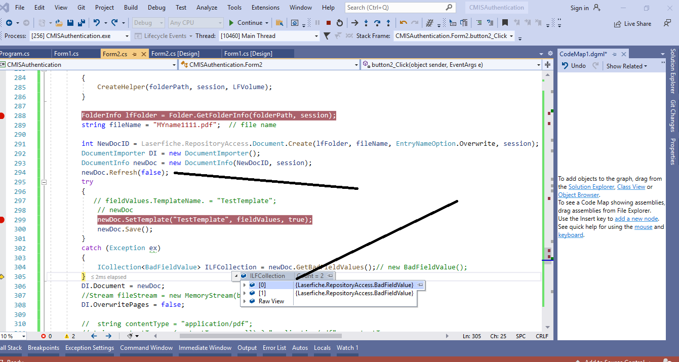

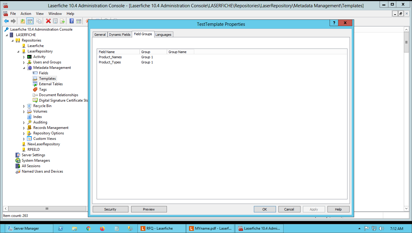

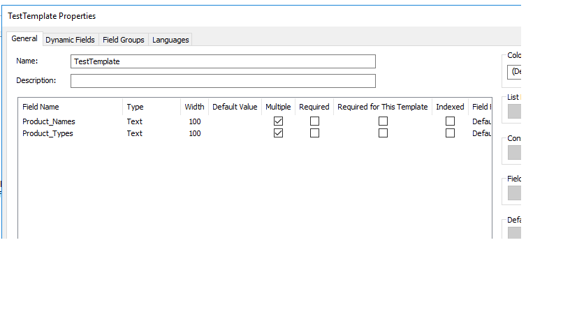

I am having problem with LF Server 10.4.3 to save multilevel values in document using SDK programming.
For LF server 10.4 everything works fine but same code not works for 10.4.3 enviorment.
Please find attachment with Template , source code and also error screenshot. I am using 10.4 version DLL for Laserfiche.RespositoryAccess and Document service.
Here i am also attaching source code which implemented by me.
Source code.txt (13.38 KB)

replied on May 10, 2021
What is in the BadFieldValues object?

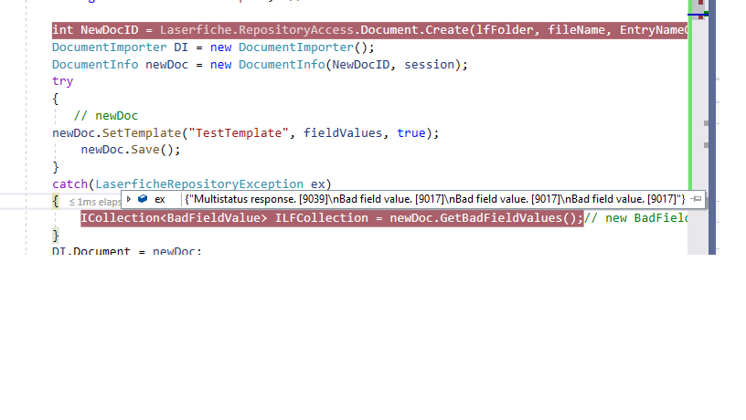

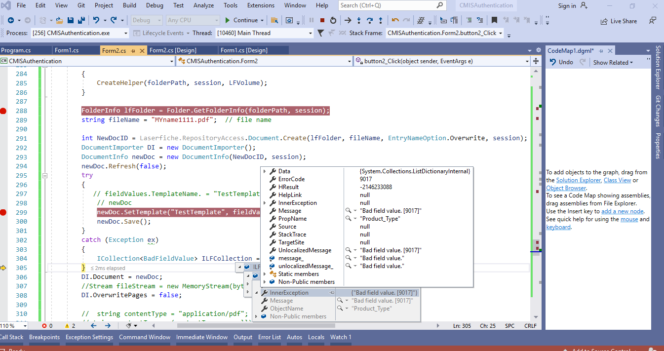

Hello Robert,
Please see details of badfieldvalues object. on 10.4.0 LF server everything working fine.
But with 10.4.3 same code did not work.
Thanks,
Pratik Barot

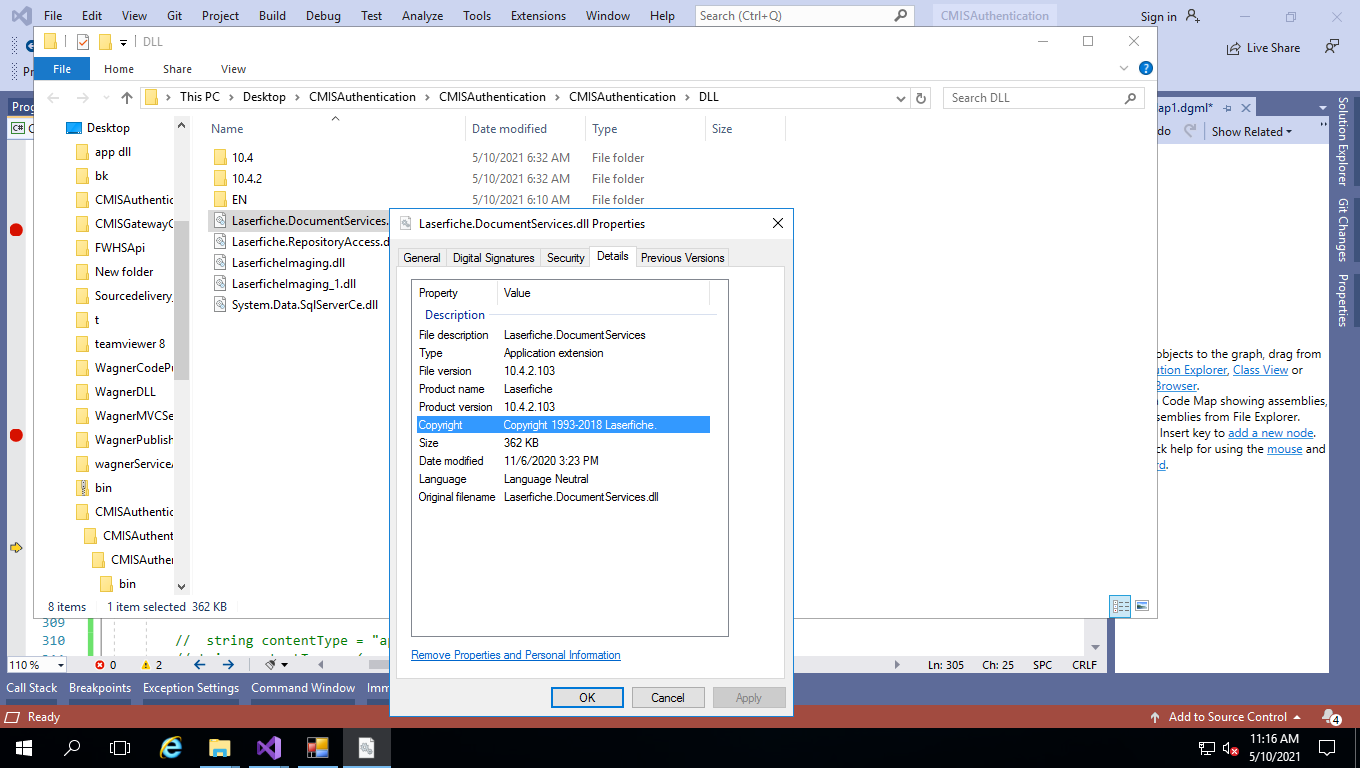

Hello Robert,
I am using attached source code  along with dll version 10.4.2.103 ( both laserfiche.repositoryaccess and documentservice )
facing problem since last 7 days. Only problem with multilevel fields in template.
Thanks,
Pratik Barot
code sample.txt (16.03 KB)
DLL version.png (91.39 KB)
