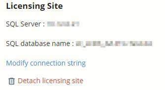

replied on May 7, 2021
Chase,
I do understand the security concerns, but the current SQL Server and Database name are already being shown before you click to edit the Connection String. Can that be configured to show when you click the "Modify connection string" link as well?

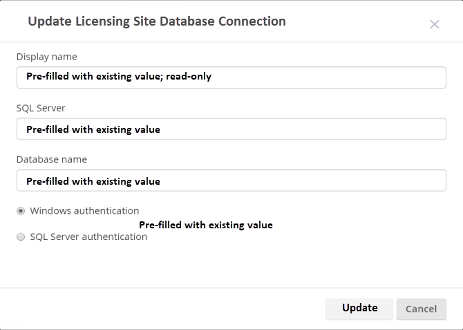

We're considering something like the UI you see when initially setting up an LFDS database. See the mockup below.
(Obviously would not pre-fill the SQL Server auth Password field).
Is that closer to what you'd consider ideal?
Your image does not show. Can you try to repost it?
Added as an attachment. Can you see it now?
replied on May 10, 2021
That is glorious!
