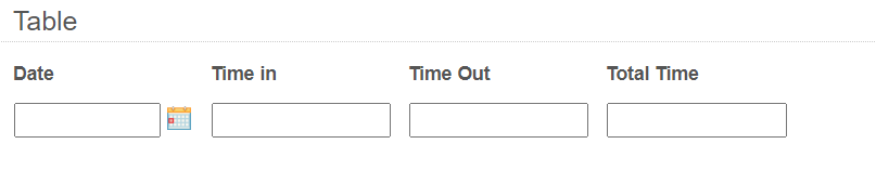

In a form I am creating I have the following table:

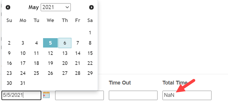

when I click the Date picker I get this:

What am I doing wrong; How do I make the NaN not appear?
replied on May 6, 2021
It doesn't look like you're calling parseNumber() anywhere. The subtotal variable just gets set and then used based on what you're puling for hour and rate.
Pieter,
Thank you for helping.  I should have said I was new to coding.  Can you give me an example of where I would put parseNumber() in the code?
I think the easiest would be to use it in the subtotal calculation like
subtotal = parseNumber(hour.diff(rate, 'hours', true));
