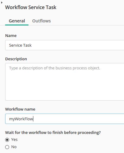

I am unsuccessfully attempting to initiate a Workflow through Forms. Whenever I run an instance of the forms process, the instance is instantly terminated.
I have my workflow published and the service task is referencing the exact same published name.
I have checked in the Workflow Admin Console and verified that web service is set to the Forms server.

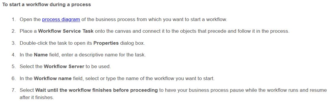

I am using the following link for reference: https://www.laserfiche.com/support/webhelp/Laserfiche/10/en-US/administration/#../Subsystems/Forms/Content/Service-Tasks.htm#WorkflowServiceTasks
Step #5 in the reference material states suggests that I should have a "Select Workflow Server" field in my Workflow Service Task properties pane but as you can see in the screenshot provided, my pane does not include that. Could this be the issue or does my version of forms make that 5th step unnecessary?
Forms Version:  Professional Version 10.4.0.1256
Workflow Version: 10.4

The Workflow server selection was not available in Forms 10.4.0. Only one Workflow server is supported in that version (and it is specified in the configuration page).
