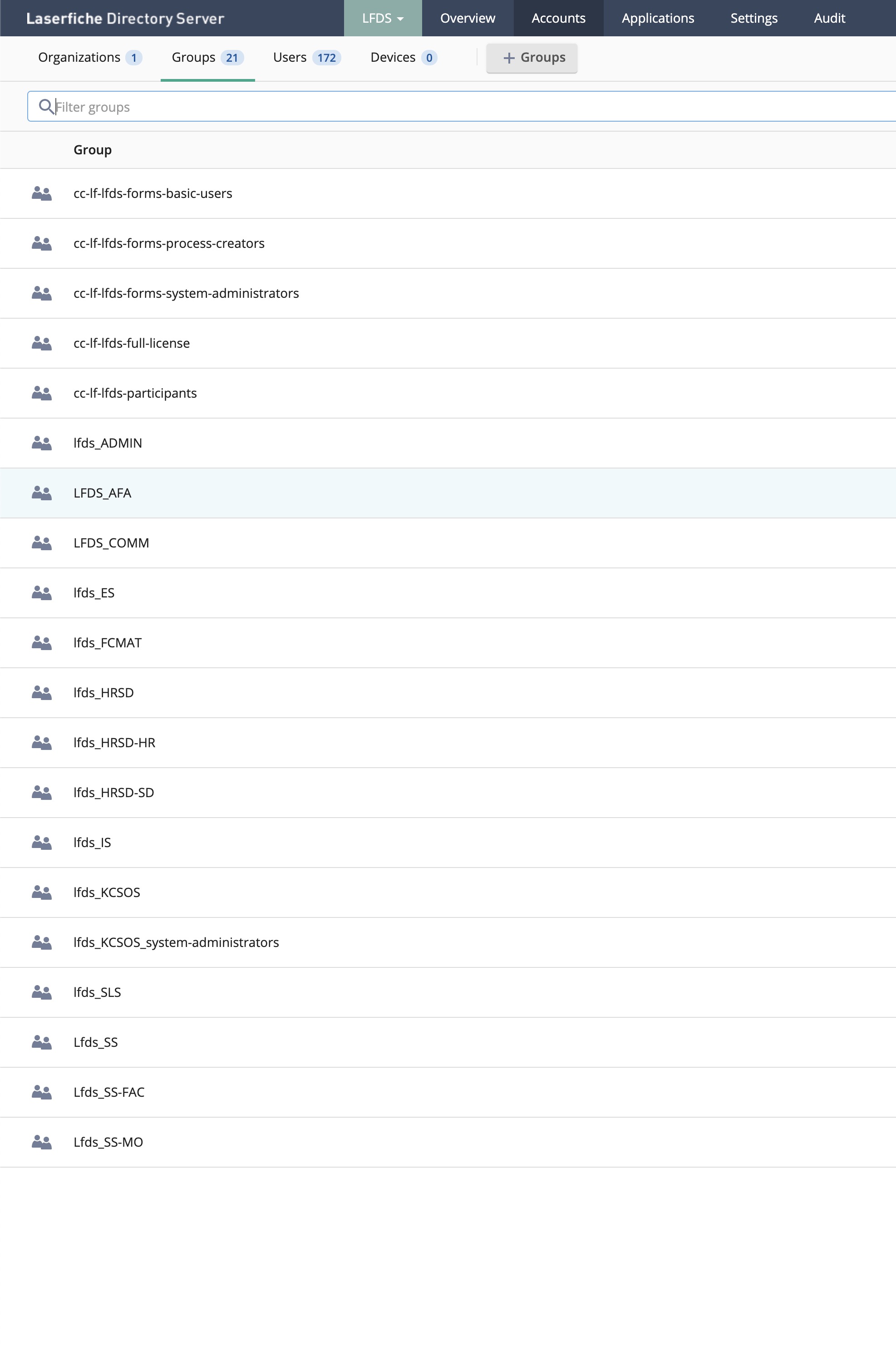

We're in the early phase of a migration to Laserfiche 11 systems and we've encountered a UI bug while testing and building out some initial LFDS Groups.
From the 'Accounts' > 'Groups' section of the Web UI, when we add more than 20 LFDS Groups, they fail to display and there is no pagination offered either. So any groups beyond the first 20 will simply appear to not exist and this leads to some confusion.
We have verified the Groups do exist and have been successfully added to the LFDS database. These Groups are also able to be discovered via the 'Filter groups' search / input field located on the same screen, and they will be displayed properly, but only after you've filtered for the specific Group name or partial keywords of the otherwise hidden Groups.

After further experimentation I've discovered that this is a bug in the LFDS UI that is triggered by browser window height.
I'm on a very "tall" 5k display and I typically run my web browser in full screen. Same goes for my RDP sessions and their web browsers. Large screen real estate, why not use it?
The problem is the frontend UI logic is restricting the number of records displayed on the Groups page to 20, unless the browser window height is less than 'X' (or scroll / viewport etc).
So this bug has had me scratching my head because it's consistent until I logged onto a laptop with a smaller resolution and noticed that immediately the previously hidden records were right there on display and scrollable. To test I immediately RDP connected to the same laptop (in my native 5k resolution, and the records were all on display still, and only after a browser refresh / page render would they disappear).
I've now verified that by toying with the browser window height, you can successfully reproduce the issue with more than 20 LFDS Groups to display.
