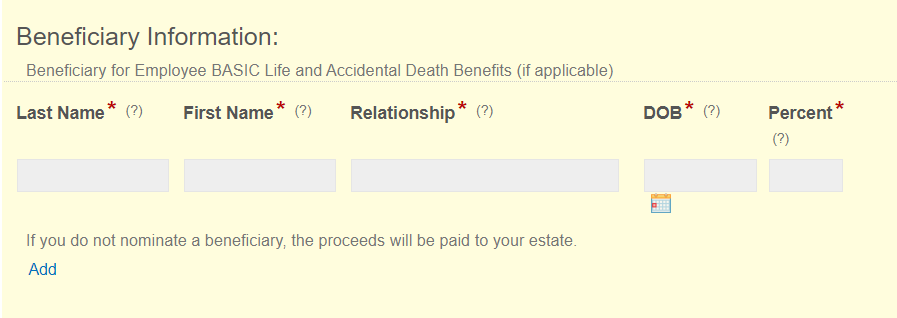

I have built a form and I'm trying to come up with a way to make it mandatory for the "Percent" field to total 100%. The person filling out the form can either put 100 in the first row, or can add additional rows and assign each a certain percentage, but the rows must total 100. If they do not, I don't want the form to proceed.
How do I go about doing this?

You could add a Total Percent field outside the table and use a formula
=SUM(table.Percent) to get the total sum of the percentage
Then you could use validation to make sure total percent was minimum 100 and maximum 100

replied on May 6, 2021
Well, this was simple and perfect. Thank you Jared! Worked beautifully (as soon as I changed my percent field to a number field).
