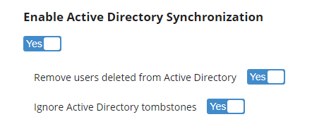

If your LFDS is setup to remove users deleted from Active Directory, they will be cleared out.

Thank you for your response. Unfortunately, this doesn't solve the issue since they don't want these users removed from AD. They have more than one AD group and these users were moved into one that does not get synced with LFDS, so if we remove them from LFDS they will not get put back in LFDS on the next sync. But we still need to remove them from LFDS in the first place.
