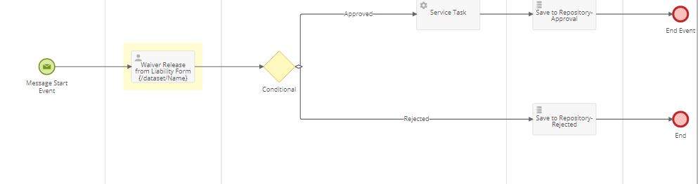

Hello,
I'm created a form that approved or rejected and I want to catch all data OR at least get to workflow works but I'm having a hard time building a Process and Workflow this is what I'm come up with for now I just want to know how to connect my business process to the Workflow and Laserfiche Repository? Please show me an good example if you can and if you need more info please let me know??

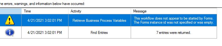

replied on April 28, 2021
If you click over to the "Messages" tab in the instance details (in the Workflow Designer), what is the warning message for the Retrieve Business Process Variables activity?
Hi Miruna,
Retrieve Business Process Variables This workflow does not appear to be started by Forms. The Forms instance id was not specified or was empty.
WF 3.JPG (28.2 KB)
Are you running this workflow from the Designer by pressing the play button? If so, that is expected behavior since it wouldn't have information on which Forms process instance to pull data from.
For testing purposes, you can click on the "advanced properties" button in the properties of the Retrieve Business Process Variable activity (the gear icon in the top right corner of the properties pane) and hardcode the IDs of the forms process and submission.  OR you need to run the full "pipeline" from the first submission in the Forms process so it calls into Workflow with the information needed.

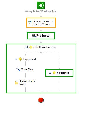

Ok this look promising, I will try this, my next question is what you think of my workflow do you think this design will work??
replied on April 29, 2021
It's not really clear to me what the bigger problem you're trying to solve is. From the workflow definition, it looks like you're attempting to move something into Approved/Rejected folders based on something that happens in Forms. But you already have logic for that on the Forms side, so I'm not sure what Workflow is intended to do.
replied on April 29, 2021 Show version history
Yes, I do realize that the workflow I create is not need at all because the process is already done in Forms. Plus, I do appreciate your help.
