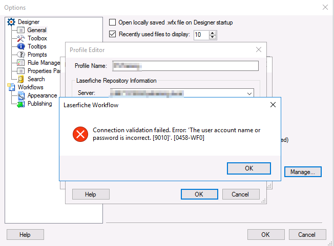

Environment 2: Fresh install of Laserfiche 11 using the Deployment Toolkit 1.0.4. An account named Workflow and a group named Service Accounts that it belongs to were created by the Deployment Toolkit. I added the Service Accounts group to the Administration Console and it was given full rights and privileges as well as given full access rights to the repository. When I try to add a default profile in the Workflow Designer using the Workflow account I receive the following error:
I'm not sure why this works in one environment and not the other. I have verified that a Workflow account does not exist as a repository account in environment 1. If I add a repository account in Environment 2 it works correctly.

Figured out the problem. In LFDS the account was set to use MFA. After turning it off for the workflow account I was able to add it correctly.

replied on April 22, 2021
