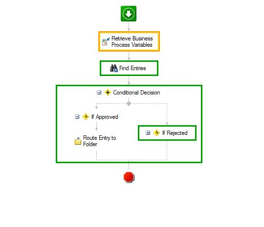

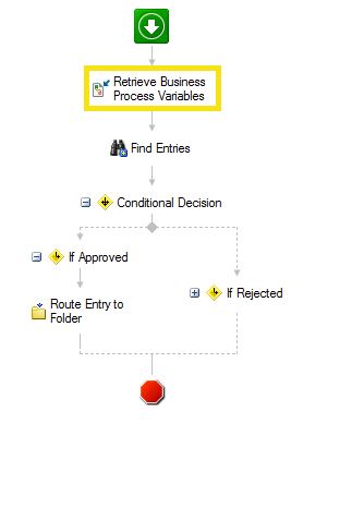

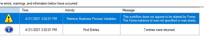

How do a Retrieve Business Process Variables from a form I try to run it and I don't know it running right or not and I keep on getting this warning while running the workflow??

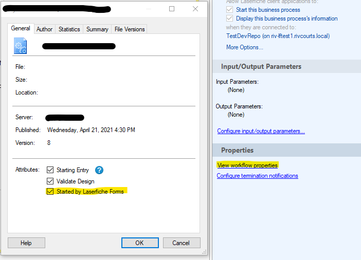

Make sure you check the "Started by Laserfiche Forms" box in the workflow properties.

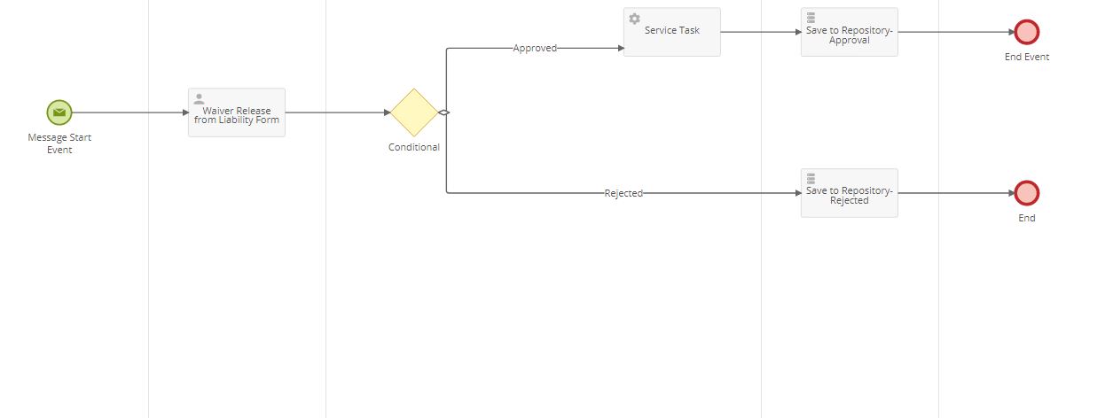

Are you starting the Workflow with your Service Task in Forms? It looks like you might be manually starting the workflow, or triggering it from activity in the repository. It should be started by Forms in the process diagram.

The screenshot showed a Service Task in the process diagram, so I'm assuming it just didn't have the "Started by Forms" option set in the workflow so it wasn't detecting the starting values.

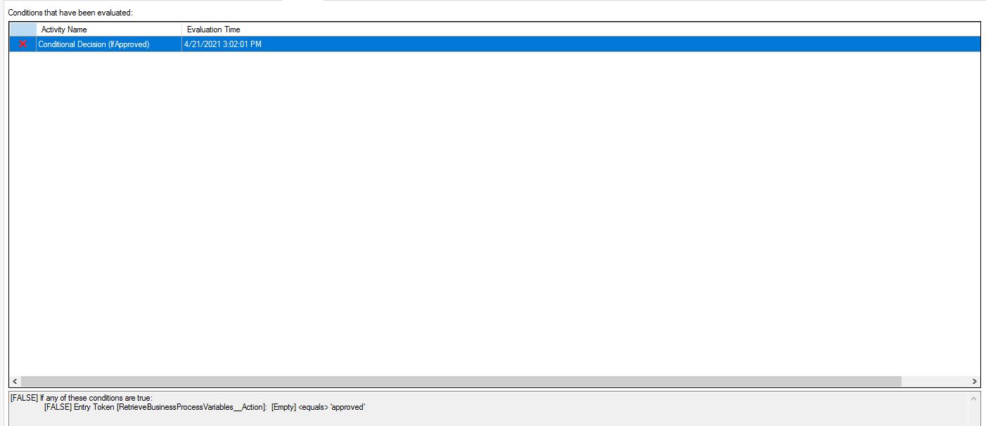

If you run it manually, it won't have a "Starting Form" from which to pull the data hence the error.
If you have it set in your forms process but it isn't running, then what does the instance history look like? Is it even hitting that branch?
If not, it could be a problem with the gateway. If it's hitting that branch but getting stuck/suspended it could be a different issue.

Check out the screenshot in my other post. In the workflow designer there's a link in the lower right for Workflow Properties.

Also Jason, can you show me example on how to create a workflow by using the Retrieve Business Process variables?? Also yes I did check the "Started by Laserfiche Forms" box.

The example you have looks fine, and if the box is checked, then you need to look at your Forms process to make sure it is actually hitting the branch that triggers the workflow.
Run the form, then look at the instance details to see what path it followed.
