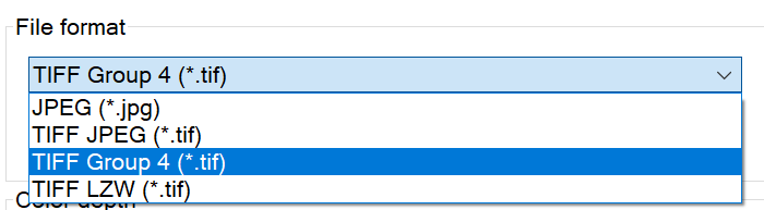

Thanks so much I think the reason this started occurring is that they started using LF snapshot.  I cannot seem to find a setting for snapshot to generate a pdf so they are able to checkout the documents and work on it.  the only formats it is giving me for snapshot is :
any ideas around this?
replied on May 17, 2021
I'm not sure about Snapshot settings. But Snapshot fundamentally produces images, so any pdf produced by this process would just contains pictures. This type of pdf is much less useful to work with than the original document, even if it is technically editable.
If users are going to be editing the document they should leave it in its native format and not Snapshotted. What problem were they trying to solve with Snapshot?
replied on May 20, 2021
Trying to save direct to LF was our issue, and a lot of users did not want to print as pdf then drag and drop in
