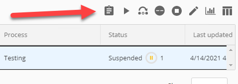

In the process diagram, whenever I add a single field in Configure Fields inside the Save to Repository Service Task and test the process, the repo service task stage gets suspended with no message. If i go back to the process diagram and remove the single field that i added, the suspended processes resume and successfully upload without any fields for metadata.

Hi Fernando-
The Event Viewer on the Forms server should give you some information about what's going on, which you can also get to from the Monitor tab in Forms.
Common reasons for this would be putting an invalid value into the field--for example, if there's a constraint to limit the type of input. Or if you're trying to set a single field with a template, but there's another field on the template that's required.
