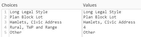

In this example, my type field has these items and I changed the Value for #4 to "4" attempting to simplify the formula:

  • The value for option four in the dropdown is 4.
  • I was thinking the IF statement would only see the 4 when option four was picked in the drop down.  Is that NOT the case?

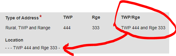

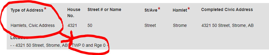

Thanks, Jared.  That does help!  In testing, I still have one problem:  The formula is supposed to fill the target field with "TWP..." only if it finds the 4th option in the Type drop down.  In testing, I'm still getting these results:

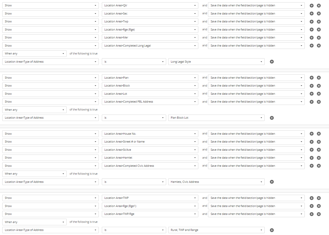

For your field rules, do you have it set to "Ignore data when the field is hidden" or "Save data..."?
If you ignore the data, the hidden fields will be blank. You need to save the data while the field is hidden.
If that's not it... I'm pretty confused now. The first collection you showed has all sorts of different fields than the latest collection you've shown. Is that all the same collection with different hidden fields? Or another collection?
The formula I gave you should be able to fill the TWP/Rge fill correctly based on which was selected in Type of Address and the values in TWP and Rge. I don't know why any JS isn't working.
replied on April 16, 2021
Set to Save data:
replied on April 16, 2021 • Show version history
Jared, to clarify:
1) The formula IS actually filling correctly now. Thanks!  It's just filling regardless of the IF statement.
2) The JavaScript that is working on the multiline field that is not part of the table IS working correctly, as well.
3) The working JavaScript is what is showing me that the formula for TWP/Rge is actually filling regardless of the IF statement.  (At least, that is what it appears to be telling me.)
The form is to fill the collection fields when the right type of address is used, otherwise leave them blank so that the Location field that is going to be used as a column in a report will always have the right address:

This is what shows up when you first choose the rural address option and properly leaves the collection field blank until at least one of the pieces is filled:
But, I can't get it to add the TWP before the resulting collection:
When I try to add that piece into the formula, it then just fills with TWP and nothing else.
