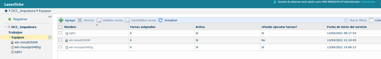

I have a problem with the DCC. I created a cluster with 3 members, 2 worker and a scheduler. In a workflow I sent a job to make pages and OCR. When I put the 3 members as a worker, all the works went to the main host. So, I made this host only a scheduler with the other 2 workers.

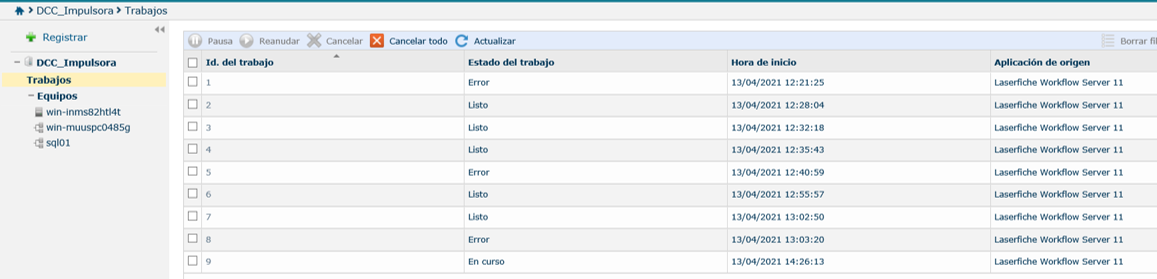

I run a new job with the Workflow. As you can see, the task 9 is on course.
The configuration is 2 workers, the other one is no availabe to run jobs.

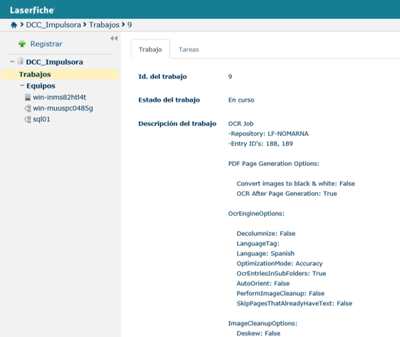

The job beguns... or at least looks like beguns...

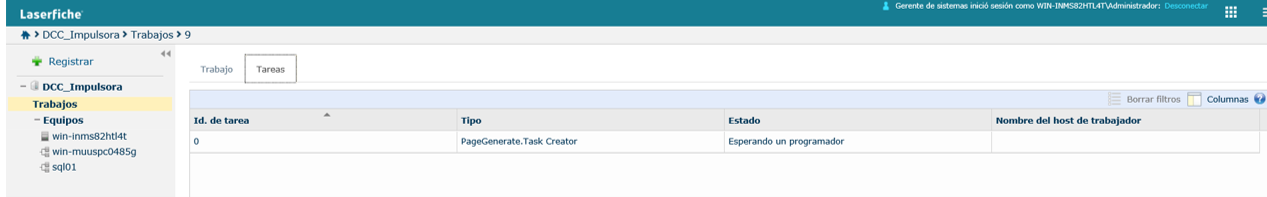

If I went to the taks, the job is on "waiting for a scheduler"
I don't know if I need to configure the other host as a scheduler or miss something in the configuration... but this jobs his waiting and no longer works...

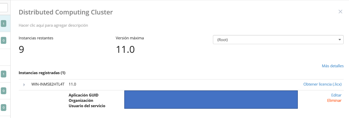

replied on April 13, 2021
Hello
This is how my LFDS had the licenses:
How I configure the workers with a license to "work"? Because in the installation, only for the scheduler ask for a license...

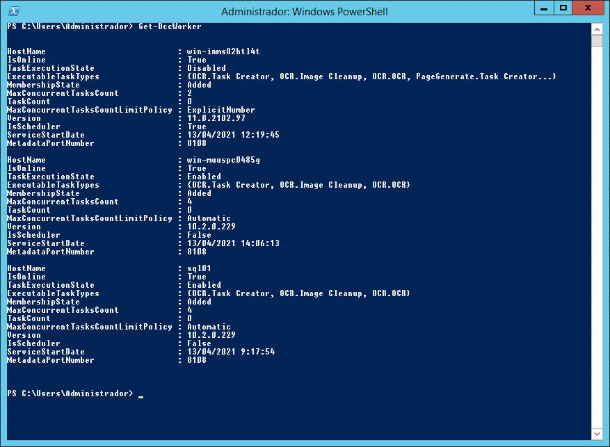

This is the configuration, via PowerShell

Unfortunately these screenshots don't have that information. On the scheduler, restart the DCC service, then look in the Windows event log under Applications and Services\Laserfiche\DistributingComputingCluster\Admin.
You should see something like this:
Laserfiche Distributed Computing Cluster Service started successfully.
License:
Product ID: 62
Expiration date: 2/11/2022 12:00:00 AM
Maximum number of additional workers: 2
Allowing Undefined Modules
Defined modules:
-Name: OCR; Number of nodes: 3
Communication:
Starting main service using latest settings, succeeded.
Port: 8107
Security mode: None
Authentication mode: None
The maximum number of nodes should indicate how many workers are allowed.

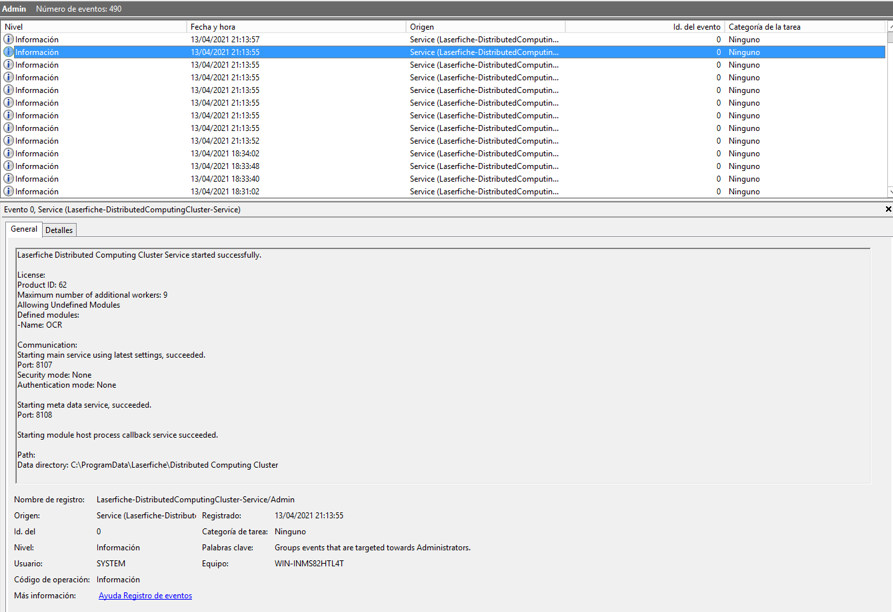

Hi
This is what I get:
License:
Product ID: 62
Maximum number of additional workers: 9
Defined modules:
-Name: OCR
Communication:
Port: 8107
Security mode: None
Starting meta data service, succeeded.
Port: 8108
Starting module host process callback service succeeded.
Path:
Data directory: C:\ProgramData\Laserfiche\Distributed Computing Cluster
It's say that I have 9, but only one Worker "work"
