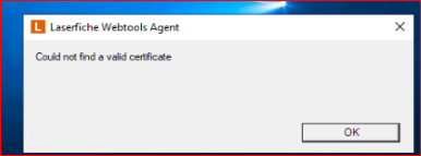

Dears,
After installing the office plugin for WebClient 11 "LfWebOffice110", I'm getting this message;

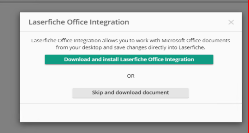

And I can't open any office document to edit from the web-client, each time system is showing this message.
A already downloaded and installed the Office Plugin.

The url for the certificate it is downloading is https://public-laserfichelocalhost-certificate.s3-us-west-1.amazonaws.com/lflocalhost.pfx. See if you can download that file in a web browser, it might need to be whitelisted.
Another option is to download the file I linked above and save it to %localappdata%\Laserfiche\Webtools Agent\Certificates (e.g. C:\Users\username\AppData\Local\Laserfiche\Webtools Agent\Certificates) and then restart webtools agent (bullet point 2 below).
If that doesn't work, enable debug logging to get more detailed logs:
1. Run C:\Program Files (x86)\Laserfiche\Webtools Agent\LoggingUtility.exe and check "Enable debug logging"
2. Restart webtools agent: from task manager, kill "Laserfiche Webtools Agent.exe", then restart it by running C:\Program Files (x86)\Laserfiche\Webtools Agent\Laserfiche Webtools Agent.exe
3. Inspect the logs in the log folder, look for "Error downloading" within the log files.

The Laserfiche Webtools Agent should automatically download the latest certificate that it needs, unless a proxy or firewall is blocking it.  Check the log files in %localappdata%\Laserfiche\Webtools Agent\Logs  (e.g. C:\Users\username\AppData\Local\Laserfiche\Webtools Agent\Logs) for any errors about downloading the certificate.
