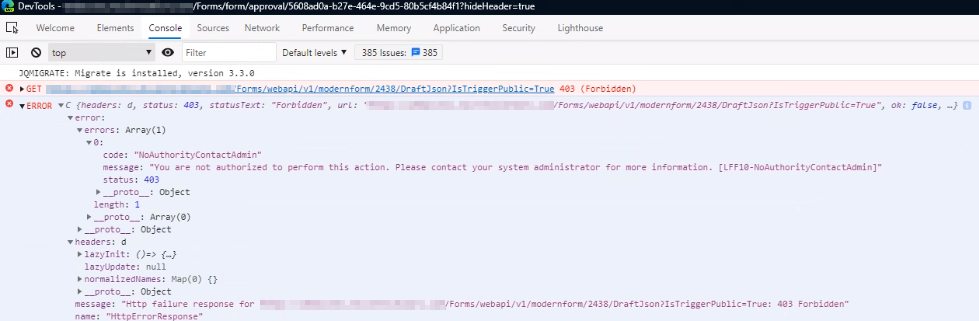

In Forms 11.0 if a user that is assigned a user task is not assigned access rights to the Forms process, and a form that was created with the Modern Forms designer is assigned to the user task, they will be able to see the task in their Inbox, but after clicking on it, it will show empty where the form will usually be displayed. If you check F12 Dev Tools-> Console and expand the messages it says:

This bug has been fixed with Forms 11 Update 1.https://support.laserfiche.com/kb/1014301/list-of-changes-for-forms-11-update-1
  • Users granted access to a process are able to perform user tasks for all forms. (316226)

I should note this only happens when using a form created from the Modern Forms designer. If you use a classic form the problem is not present.
replied on April 9, 2021
We'll investigate and should have it fixed for a Forms 11 update 11 currently scheduled for mid-May. I'd suggest adding those users as submitters in the mean time.

@████████, yes, it only affects the processes with forms using the modern form designer. It has been filed as a bug by LF Support. I have not been able to test it with Forms Portal, but I will see if I can do that and post back here.
replied on April 12, 2021
To confirm, the bug is only for user tasks with a layout form. Forms Portal should not have an affect on this bug, it's just about the form on the user task step.
