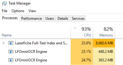

The activity on these processes picked up out of nowhere, without any indication of what is spiking them. What are some thing that I can check as to what is ticking these up so high?

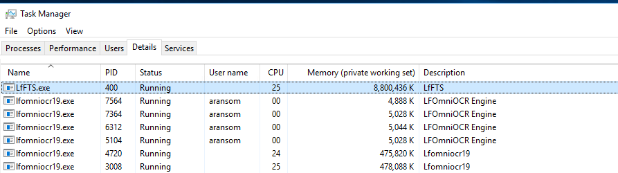

Thanks so much for the reply! On the Status tab of the Indexing properties, I can see the numbers constantly changing as I Refresh. Here's some more context. On the task manager, I see several OCR related stuff running, and the ones taking up all the power are these "lfomniocr19.exe" ones

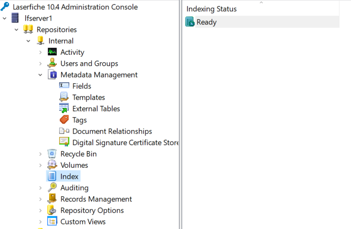

1) From the Laserfiche Administration Console, under the specified repository, select Index.

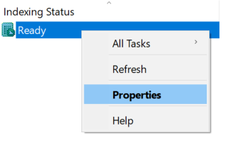

2) Right-click on the Indexing Status and select Properties.

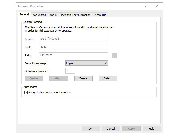

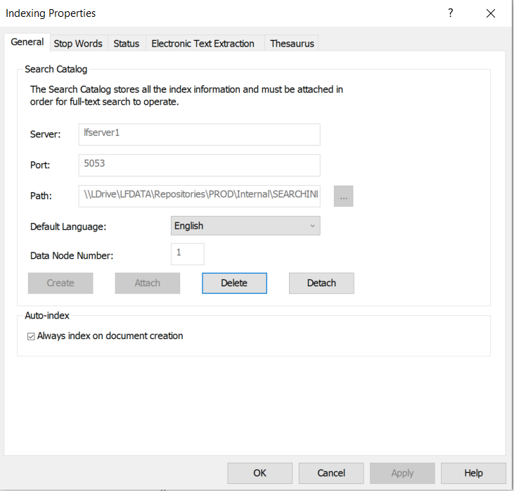

3) Once at the Indexing Properties screen, under the General tab, click on Delete, clicking OK when prompted.
4) Once the Search Index has been deleted, click on Create to re-create the Search Index.

So after deleting, I'll just have to remember to use the same Path that's here
