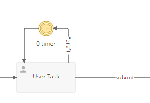

The Save Draft button isn't supposed to update variables, so maybe Save Draft isn't actually what you want.
Maybe you could do something like
That'll update all the forms variables so other users can see the changes but the user on User Task can continue editing the form.
