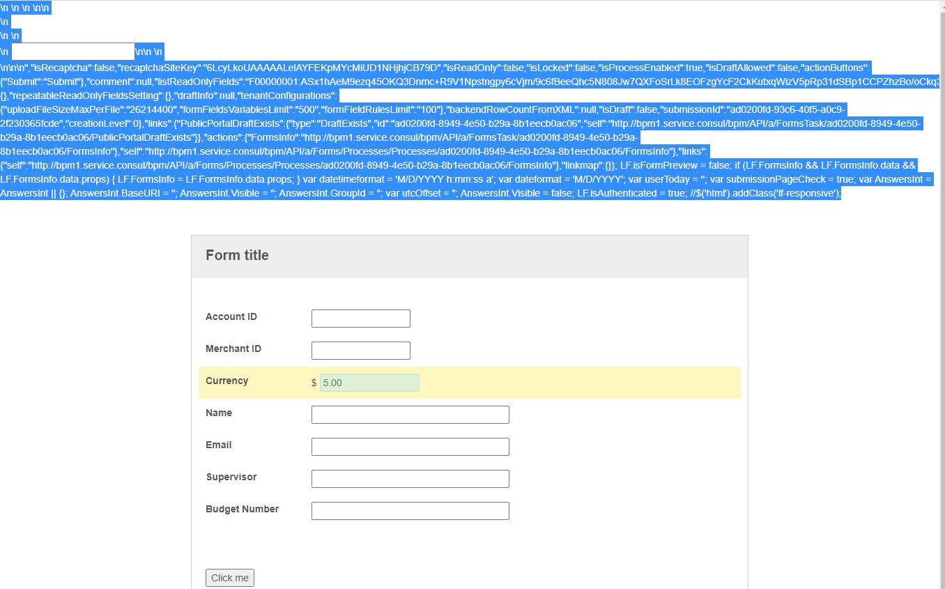

I am trying to interface an online CC processing application with a LF Cloud forms process.  The goal is to have a button that shows 'Pay Now' if the end user selects to pay by CC.  The button then triggers javascript function code which opens their application in a popup and passes various variables into their fields.  I have the onClick button created and the Javascript entered.  (I can provide the code if needed.)  The problem is the error that appears at the top of the form. (See error message below.)  I am pretty new to HTML and Javascript but I did work with the developers of the CC application.   I'm also not sure if this is something that can be done without working with the LF developers.
"\n \n \n \n\n
\n
\n \n
\n \n\n \n
\n\n\n","isRecaptcha":false,"recaptchaSiteKey":"6LcyLkoUAAAAALelAYFEKpMYcMiUD1NHjhjCB79D","isReadOnly":false,"isLocked":false,"isProcessEnabled":true,"isDraftAllowed":false,"actionButtons":{"Submit":"Submit"},"comment":null,"listReadOnlyFields":"F00000001:ASx1hAeM9ezq45OKQ3Dnmc+R9V1Npstngpy6cVjm/9c6fBeeQhc5N808Jw7QXFoSrLk8EOFzgYcF2CkKutxqWizV5pRp31dSBp1CCPZhzBo/oCkq3X2TC5M/osO6O54SuXd8Sy8weixu5j3MoZpi5FdlizYkqFoa6Kpz9L5WHzxaNZsSrhTFtu+KsopkstFOpmZYWhKQZHPflKNUQDztgKk=","readOnlyFieldsTrace":{},"repeatableReadOnlyFieldsSetting":{},"draftInfo":null,"tenantConfigurations":{"uploadFileSizeMaxPerFile":"26214400","formFieldsVariablesLimit":"500","formFieldRulesLimit":"100"},"backendRowCountFromXML":null,"isDraft":false,"submissionId":"ad0200fd-93c6-40f5-a0c9-2f230365fcde","creationLevel":0},"links":{"PublicPortalDraftExists":{"type":"DraftExists","id":"ad0200fd-8949-4e50-b29a-8b1eecb0ac06","self":"http://bpm1.service.consul/bpm/API/a/FormsTask/ad0200fd-8949-4e50-b29a-8b1eecb0ac06/PublicPortalDraftExists"}},"actions":{"FormsInfo":"http://bpm1.service.consul/bpm/API/a/FormsTask/ad0200fd-8949-4e50-b29a-8b1eecb0ac06/FormsInfo"},"self":"http://bpm1.service.consul/bpm/API/a/Forms/Processes/Processes/ad0200fd-8949-4e50-b29a-8b1eecb0ac06/FormsInfo"},"links":{"self":"http://bpm1.service.consul/bpm/API/a/Forms/Processes/Processes/ad0200fd-8949-4e50-b29a-8b1eecb0ac06/FormsInfo"},"linkmap":{}}; LF.isFormPreview = false; if (LF.FormsInfo && LF.FormsInfo.data && LF.FormsInfo.data.props) { LF.FormsInfo = LF.FormsInfo.data.props; } var datetimeformat = 'M/D/YYYY h:mm:ss a'; var dateformat = 'M/D/YYYY'; var userToday = ''; var submissionPageCheck = true; var AnswersInt = AnswersInt || {}; AnswersInt.BaseURI = ''; AnswersInt.Visible = ''; AnswersInt.GroupId = ''; var utcOffset = ''; AnswersInt.Visible = false; LF.isAuthenticated = true; //$('html').addClass('lf-responsive');

Are you sure this approach will work?  Trying to interact with a form/iFrame that is hosted on another domain is almost assuredly going to throw a cross-origin error in the browser and not be allowed unless the CC form/iFrame uses some type of event listener that allows for that communication.

   Thanks for the reply.   I really don't know if it will work.   The vendor is SnapPay.  Would the payment vendor need to have the event listener and is that security risk?
replied on April 6, 2021
Yes, the payment vendor would have to support event listener(s) and then provide instructions on how to trap those events in Forms to allow you to securely pass those values.  I have not done any research on SnapPay but we are currently going through UAT testing to deploy CardConnect via an iFrame to allow secure credit card processing in Cloud.  If you are interested I could post the links to the Card Connect API and iFrame resources that would allow you to do the same thing.
