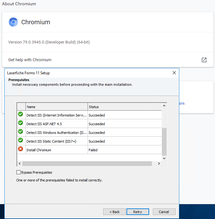

We are attempting to upgrade our installation of Forms 10.4.5.282 to 11. We currently have Chromium Version 79.0.3945.0 installed on the Forms server. However, when we try to run the Forms 11 installation, the Laserfiche Forms 'Install Chromium' prerequisites fails. I uninstalled Chromium from the server and attempted to install Forms 11 again, but ran into the same issue. I then manually installed the newest version of Chromium v91.0.4460.0, but the Forms 11 installation still throws the same error during the prerequisites step. We are not sure what to try next.
replied on March 29, 2021
We ran into this issue during testing when we installed the package from a shared network drive. When we moved the installation directory to a local path, it worked. We are still investigating why that issue occurs, but it may be what you are seeing.
replied on April 15, 2022
We have improved since Forms 11 Update 1(11.0.2106.10331) to support install Chromium from shared network drive.
