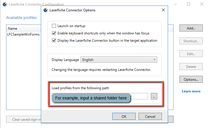

Oh, I just realized, have you set the "load files from the following path" (below screenshot), and move your profiles under that path? If not, by default, the Connector profiles you created will be put under %APPDATA%\Laserfiche\Connector\Profiles, to be more specific, it potentially would be like C:\Users\timothy.wade\AppData\Roaming\Laserfiche\Connector\Profiles, and other users cannot load profiles under your AppData.
Therefore, please try to move the profile under a public place and input that public place in "load files from the following path" field.

Yes, thank you--that's exactly what I needed. I moved my answer marking from your earlier answer to this one. I think that's likely to be helpful to someone else in a similar situation as well.
