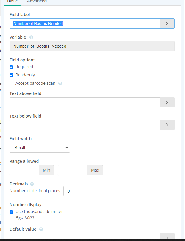

replied on March 25, 2021
I have one more question so this formula worked.
=IF(Booth_Type="A",100.00,IF(Booth_Type="B",100.00,IF(Booth_Type="C",90.00,IF(Booth_Type="D",325.00,))))
But say I wanted to add another field where they are putting number and multiply it by the amount calculated.  how would I do that.
You can use your Booth_Cost field now as a variable. If you have that long formula set for the field called Booth Cost, you can use
=PRODUCT(Booth_Cost,Number_of_booths_needed)
