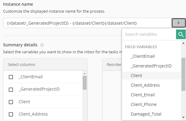

One of my variables is a Singe Line and it is removed from the instance name list options. What is the filter on this in cloud?

Chad, have you saved and published your process with the new variables? The instance name and summary details can only include variables in the currently published version. If you added a variable and saved a draft (but not yet published), that variable wouldn't show up there. You need to publish the latest draft then update the instance name to include it.

I saved the form with the new variables but did not publish the process. I was still in development. This must be the difference with cloud.

That just sounds like a visual glitch, should not affect cloud otherwise everyone would be reporting issues. I have gone to many screens to get these screenshots. Cloud is filtering out access to specific variables and I don't know what the condition is.
