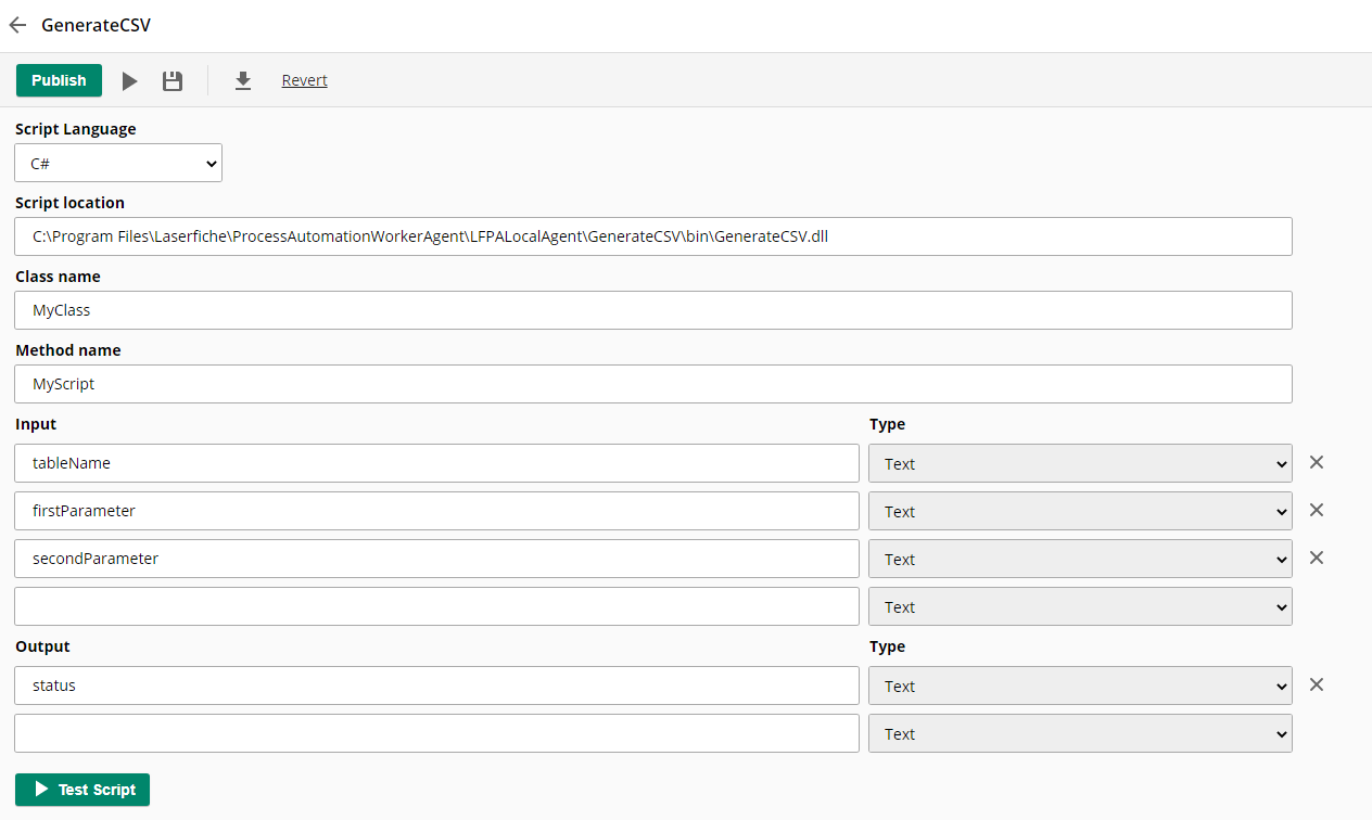

  6. Return to the Script you made in Laserfiche Cloud and use the following settings:

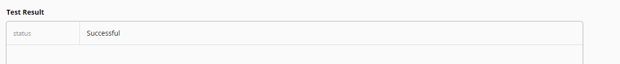

  7. When you test it, it should return "Successful" as I did not change the bool value.

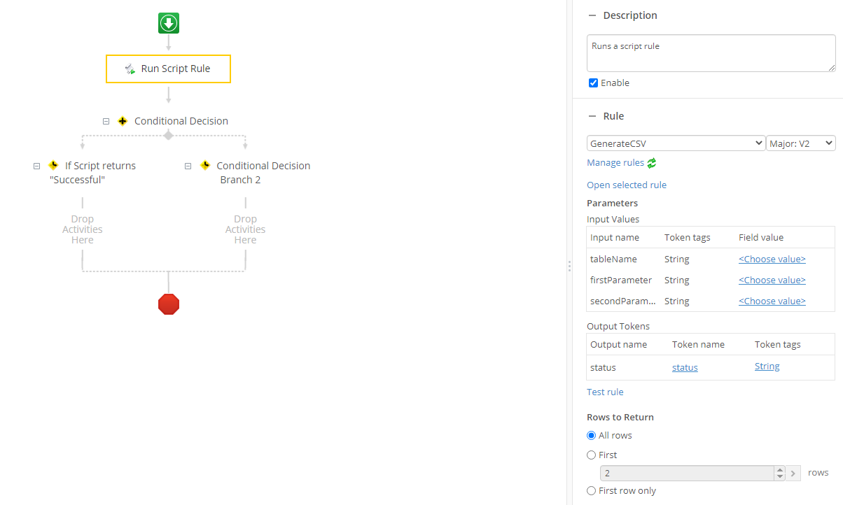

  8. Now in Workflow you can configure the following:
This example is a quick overview and should hopefully be a good starting point for what you want to accomplish.
