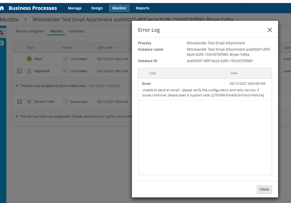

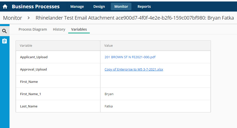

I'll attach images, but the message "Unable to send an email-please verify the configuration and retry service. . ."  Seems odd since the configuration is correct and the email works as long as you don't use the attachment section.  The second image is showing that both files have uploaded correctly and you can download them from the variables tab.

replied on March 12, 2021
Are you sending to users with verified email addresses? If the emails aren't verified, the user won't have a valid email address and that task would not have an email to send to.

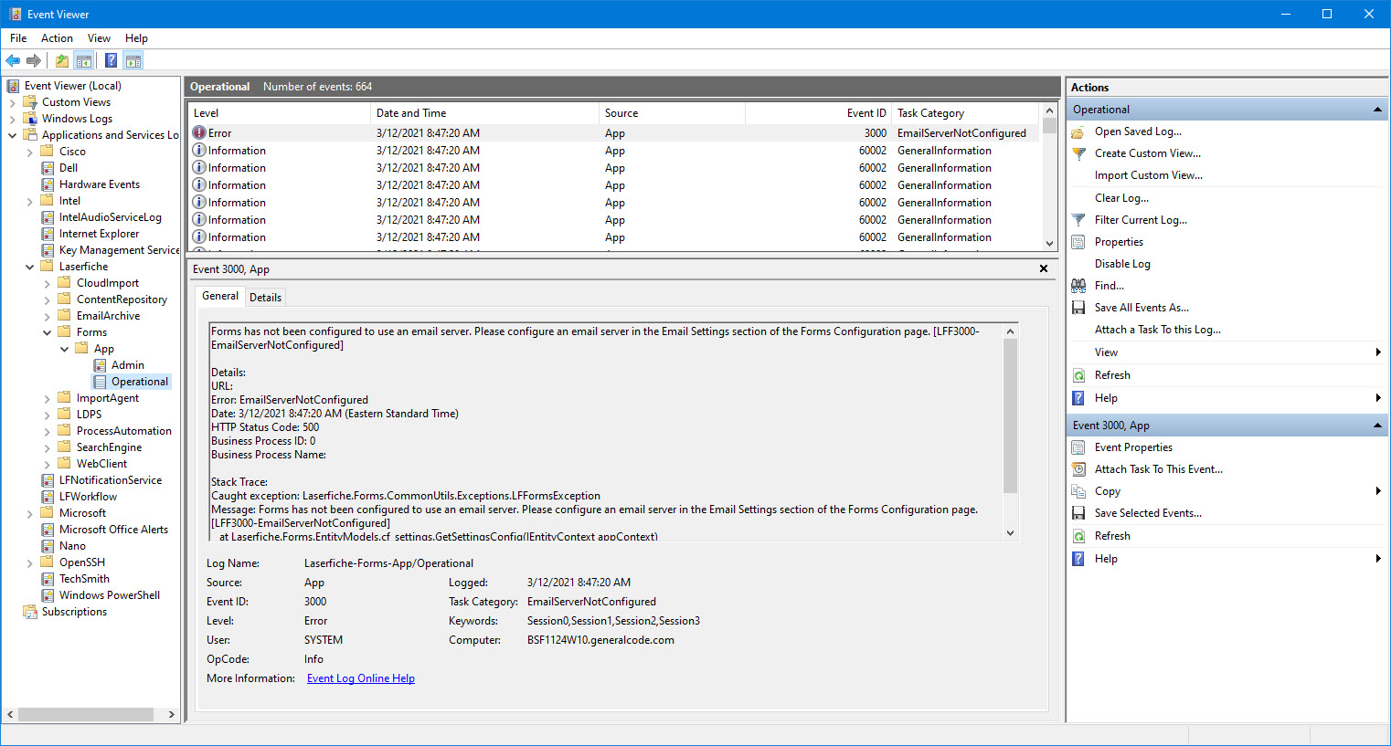

I can't reproduce the issue with Forms 10.4.5.282 and based on the screenshot attached to the support case for on premise, it seems the email notification server is not properly configured.
replied on March 15, 2021
@Xiuhong Xiang that was a mistake.  I was testing on a demo system that indeed did not have email configured for Forms.  The help desk and dev team have identified the issue for the cloud system and are working on an update to release to fix this.  Thanks.
