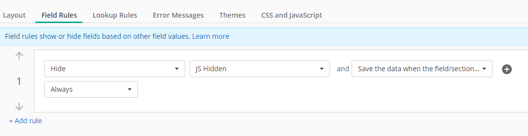

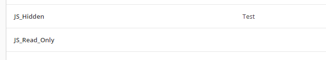

Sean, you're probably running into a Forms security feature, which is that if a field is read-only, it won't store the value if set by JavaScript (I really wish they would make this a configurable option). You'd be able to tell by looking at the variables in the completed process, to see if it's blank there, too.
However, if you make the field editable and then use a Field Rule to hide the field and save the value, it should save for you.
