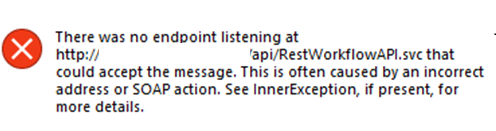

Customer edited the web.config file and now is getting a SOAP Error when trying to load WF's:

replied on March 15, 2021
Yes, the error says the config changes are likely wrong. We'd need to see the config files and any error logs that might have been generated.
