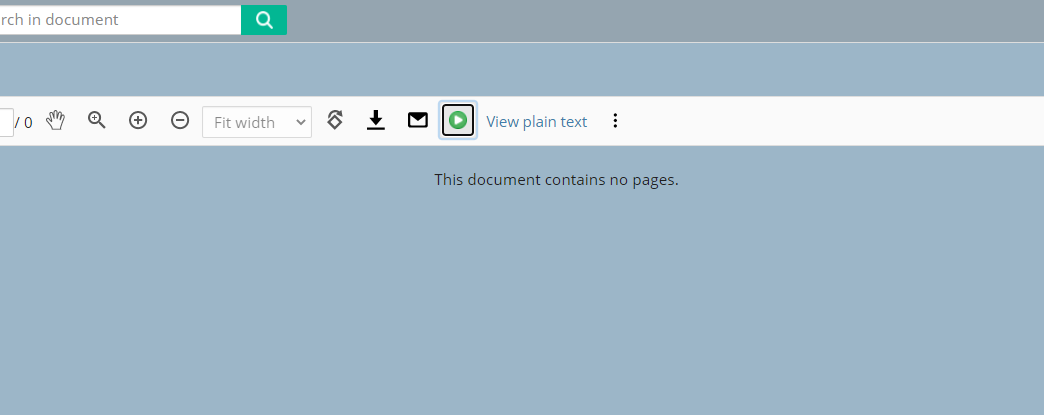

I like the feature in weblink that allows video streaming; we use it in a policy review process we've built.  The only improvement I'd like to see is some way to configure a link such that it directly opens and plays the Weblink entry's attached video file.  Can anyone think of any way to do that?
replied on February 25, 2021
Hi Sean,
something like this isn't supported out of the box currently. However in a self-hosted solution you could add a custom click event on the play button in the DocView page when user opens the page and this would show the video.
Here is sample code you could add to DocView.aspx if you pursue this option. Note this would only open the video player not set it to play directly but its a step in that direction.
I haven't worked with videos in WebLink yet, but depending on how designed I imagine you could pull this off by adding some custom JavaScript to the page.
Let's assume adding a custom query string parameter won't break the page, and that there's a way to programmatically click the "play" button via JavaScript...
You could add something like "?autoplay=true" to the end of the URL.
Get into the .aspx file for the the video viewer and add a script at bottom to look for that value when the page finishes loading.
var params = new URLSearchParams(window.location.search);
if (params.has('autoplay') && params.('autoplay').toLowerCase() === 'true')) {
    // do something
Based on my experience customizing WebLink pages, this code would probably execute before the file actually loads completely, so it would take some experimentation and digging through the structure of the page in the browser to get it all sorted out, but in theory it should be possible.
You might need to use timeouts to wait for the video to be loaded before you can click play, or if the player exists in a frame maybe you could put code in there instead.
Not really the answer, but hopefully it gives you some ideas that may lead somewhere.
