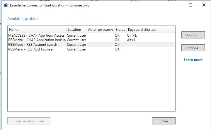

Sigh. ok so the problem with this solution was that Profile Creator was already there. It was already checked and so I had no option to move forward. So I tried Modify and UNCHECKING Profile Creator. Restarted machine. But that did not remove profile creator. So I was at same place with it checked and no place to move forward with modify. SO this time, I did an uninstall of connector. Restart machine.
Ugh. Still says Runtime only. No option to create profiles.
Tried again, running installation as admin. Tried running Connector as admin. Still says Runtime. Got a fresh license file and pointed to it. Nope.
I can't create anything with it. Super bummed. Had plans to build some cool stuff but time is running out.
Sad Roz.
I guess I could try putting it on a fresh machine. Problem is I don't have the software I wanted to build a connection with on the other machine.

Could you try one more uninstall and reinstall? But this time run it from a command prompt and add logging to it:
setuplf.exe -log C:\temp\Connector
Then we can see where things got confused.

Update: Trace log indicated there are two license files, so clearly there is some confusion for the software. I put in a support ticket with our VAR to help me clean up whatever needs to be cleaned up.
Side note - Connector doesn't always appear in my task tray. I was about to give up being able to turn on trace log when it showed up in my tray and I was able to follow the instructions for turning on logging.

WOO HOOO - solved! If anyone else runs into this ... it turned out that when I renewed our license this year, I renamed the old license as lf2020.licx ...  and did not change the file extension. SO Connector got confused seeing two lf*.licx evidently. Because once I changed the defunct license to lf2020.old ... and exited Connector and restarted it. BOOM good to go!
So it's important when replacing licenses to rename the EXTENSION, not just the file name.
