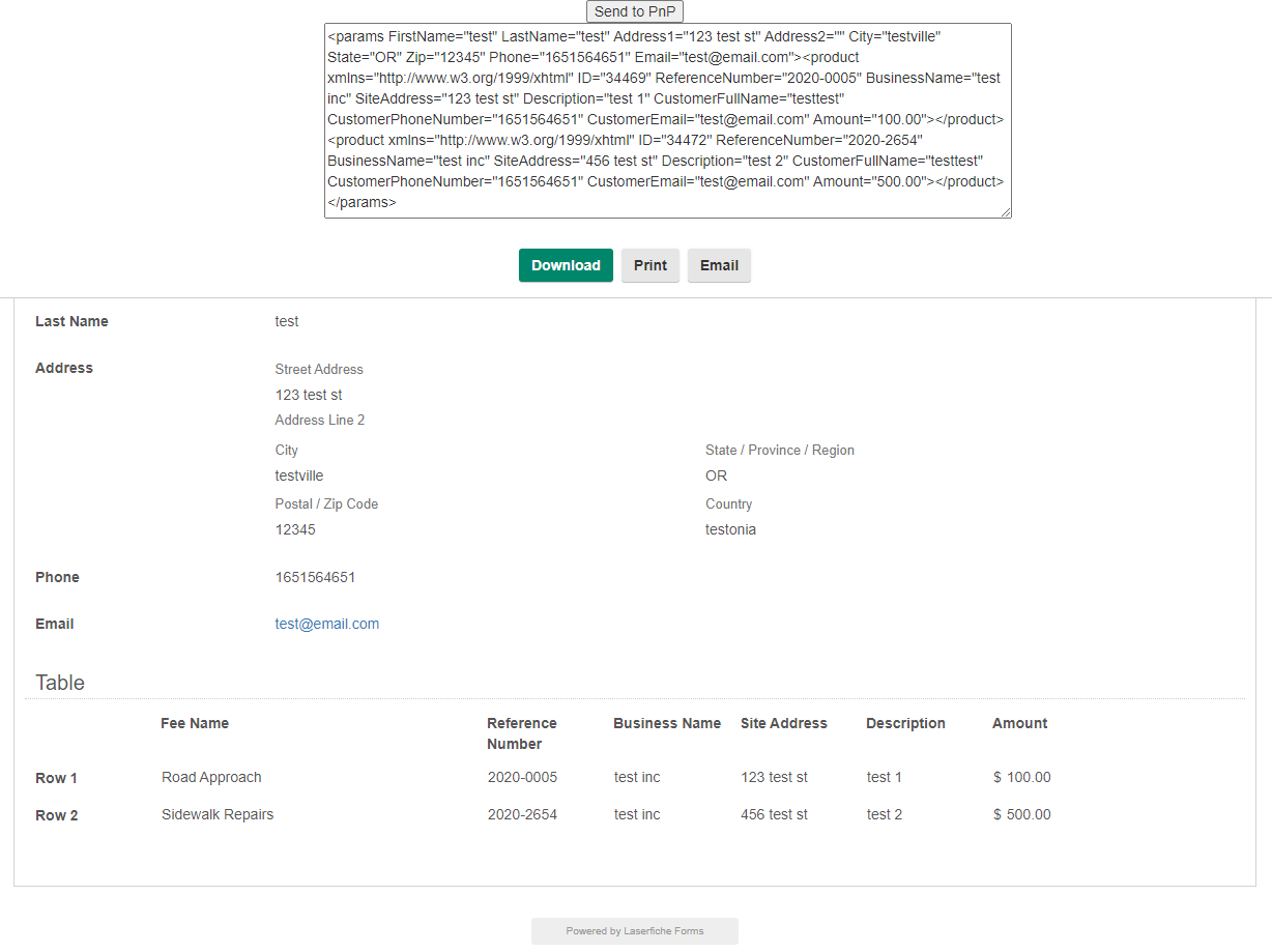

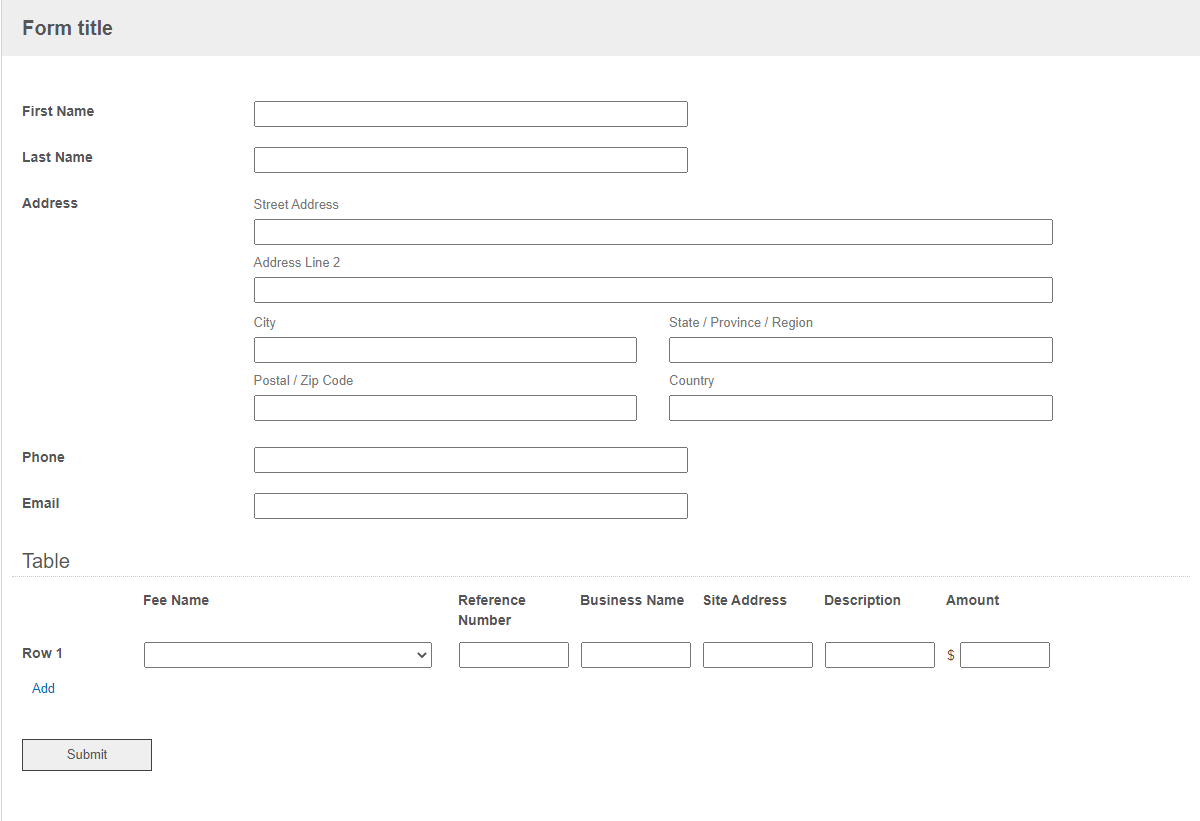

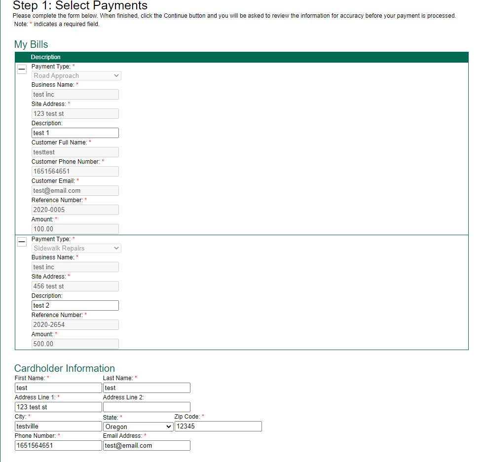

Above is the test form that was created for this project. Your form can look different, but this is what I'm using to write this how-to, so this will be your point of reference.
So once the form has been filled out and the submit button clicked. We then generate XML and redirect the user to the payment gateway. This part will be an automatic generation and redirect, but for testing, it's easier to use a button to cause the redirect. Here is what the submission page looks like.
Keep in mind I'll go over the code for this after I show the process to allow you to understand it a little better with some context. Also, the XML in the multiline input is generated after clicking the button to send it to the payment gateway (in this case it's Point and Pay). I also expanded the field so you can see the layout of the XML that gets sent to the payment gateway. Now thankfully my payment gateway was nice enough to set up a demo payment portal so I can play around with the XML and how their portal reacts, but yours may differ.
Once it's sent to the payment gateway this is the screen I see. I'll show you this part to illustrate that Laserfiche can send XML to an outside source and allow it to work without anything other than some JavaScript. Here is the beginning payment page of my payment gateway.
The customer then enters their payment info, verifies their paying the correct item, and finishes the payment through the payment gateways portal. This is where the question will go out to any users or Laserfiche staff who might be able to answer it. But first, let's talk about the code to accomplish.

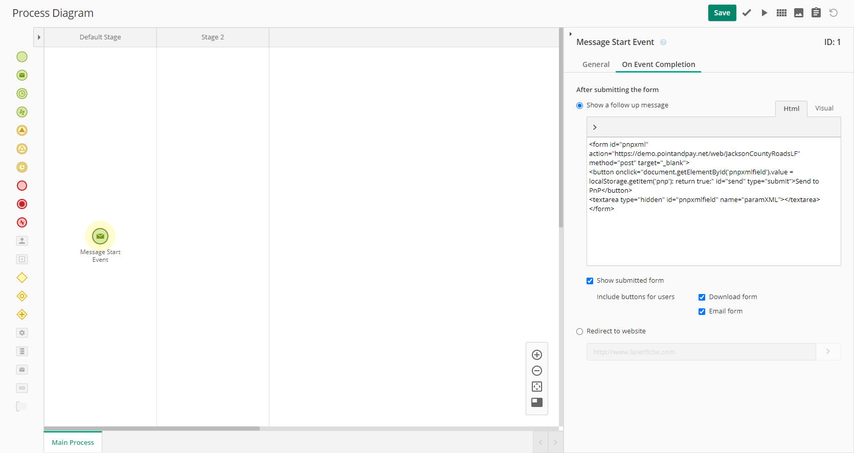

The second part of the code is on the submission page. Here is where you would enter the code:
Now the code for the submission page:
<form id="pnpxml" action="https://demo.pointandpay.net/web/JacksonCountyRoadsLF" method="post" target="_blank">
<button onclick="document.getElementById('pnpxmlfield').value = localStorage.getItem('pnp'); return true;" id="send" type="submit">Send to PnP</button>
<textarea type="hidden" id="pnpxmlfield" name="paramXML"></textarea></form>
So for the submission page we create a form element so we can send the POST message to the demo payment gateway portal.
This part determines where the POST message is sent (action) and the fact that it is POSTing to the URL (method). The target is set to blank to make the redirection of the customer open a new tab. This can be changed if having it open a new tab is not ideal.
This is the button seen in the picture of the submission page. The onclick portion is what returns the XML document we stored in localstorage from the form. You can see that it "gets the item" pnp from localstorage and sets the multi-line field or text area to the value of the XML document.
This is the text area seen in the picture that is filled with the XML. And also the closing tag for the form.

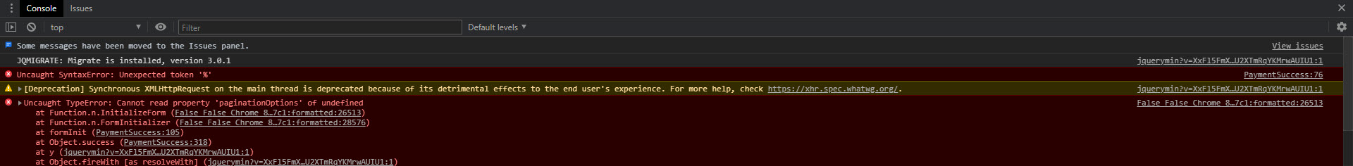

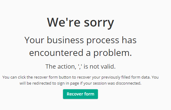

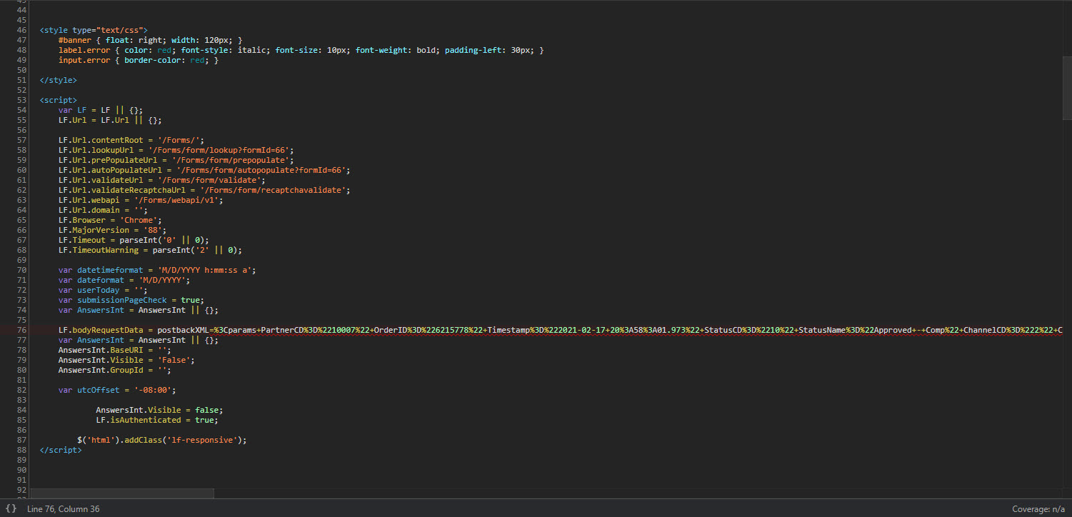

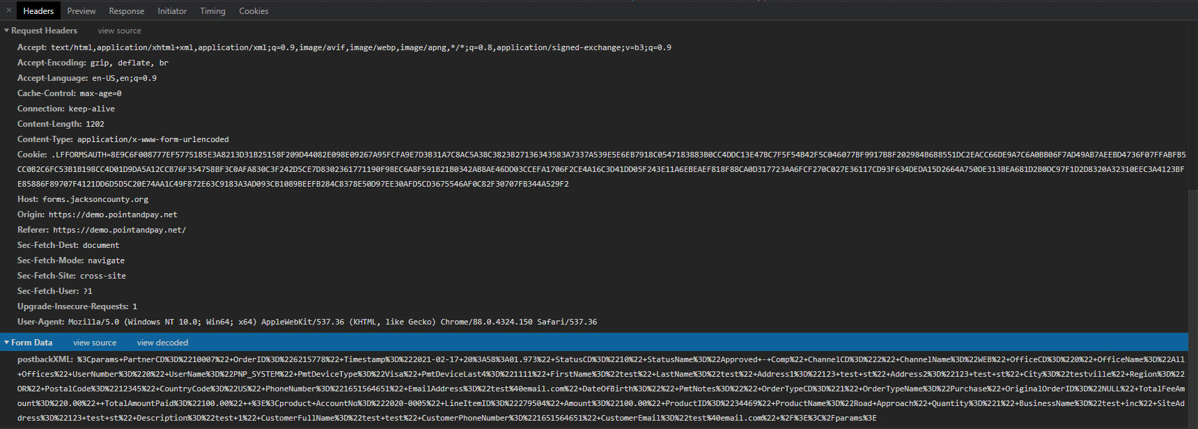

Once the customer has entered their payment info and submitted it to the payment gateway the payment gateway will redirect them to another Laserfiche Form. This is where the problems start. Point n Pay current is sending an XML document back to Laserfiche Forms as they don't seem to be able to add parameters to the redirection URL (See this link for more on that: https://www.laserfiche.com/support/webhelp/Laserfiche/10/en-US/administration/Default.htm#../Subsystems/Forms/Content/populating-a-form-with-url-parameters.htm%3FTocPath%3DForms%7CCreating%2520a%2520Form%7C_____9).
So once the form attempts to load I receive a white screen. Below are some snapshots of the issue from the Elements, Network, and Console windows of the Developer console in Google Chrome.
If anyone has successfully got a POST message with encoded XML as a field in the request body to work with Forms this how-to could be completed. But until then, I can only get you that far. The XML from the POST message sent by the payment gateway seems to break the form.

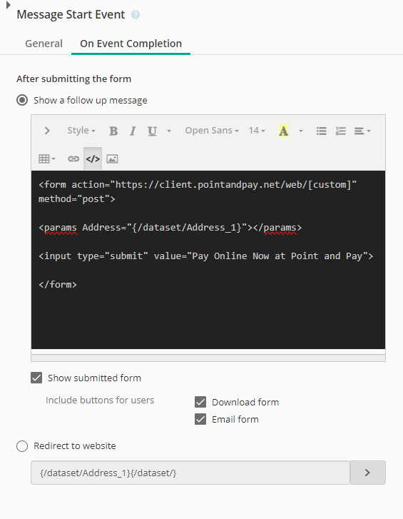

Forms supports completing a message start event using HTTP POST, you can refer to https://doc.laserfiche.com/laserfiche.documentation/11/administration/en-us/Default.htm#../Subsystems/Forms/Content/Processes/Completing-a-Message-Start-Event-using-HTTP-POST.htm, the value of a field needs to be in the format as following which is JSON
data: JSON.stringify({'Single_Line':'123'})
replied on February 26, 2021
That is very useful information. I'll have to see if the payment gateway provider can send the parameters from the payment through JSON. If not I'll likely have to set up an external site to convert the XML to JSON and pass it to Forms. Thanks for your insight Xiuhong!
