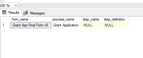

Hi Matthew
I was able to successfully run the query but it only returns this result. Not sure how it will lead me to the reference
replied on February 24, 2021
Those last two columns should be referring to the user task step that is using the form - the fact that those are NULL confirms you assertion that no tasks are linked to the form.  Really odd that you're getting that error about not being able to delete the form.
