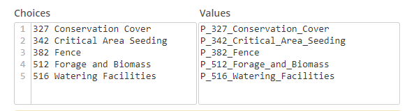

I have a Fillable PD that has a section where staff enters pre-established text (technical standards).
To avoid having staff type it every time they need to generate this PDF, I created a form that has all the possible options as checkboxes (they can have more than one).
The problem is that if I use the general Variable name %(RetrieveBusinessProcessVariables_ContractTechnicalStandards), I get only the first option selected. And, I get the Values (with the underscores).
If do this instead:
I'll obtain the words True, False, False, True, False.

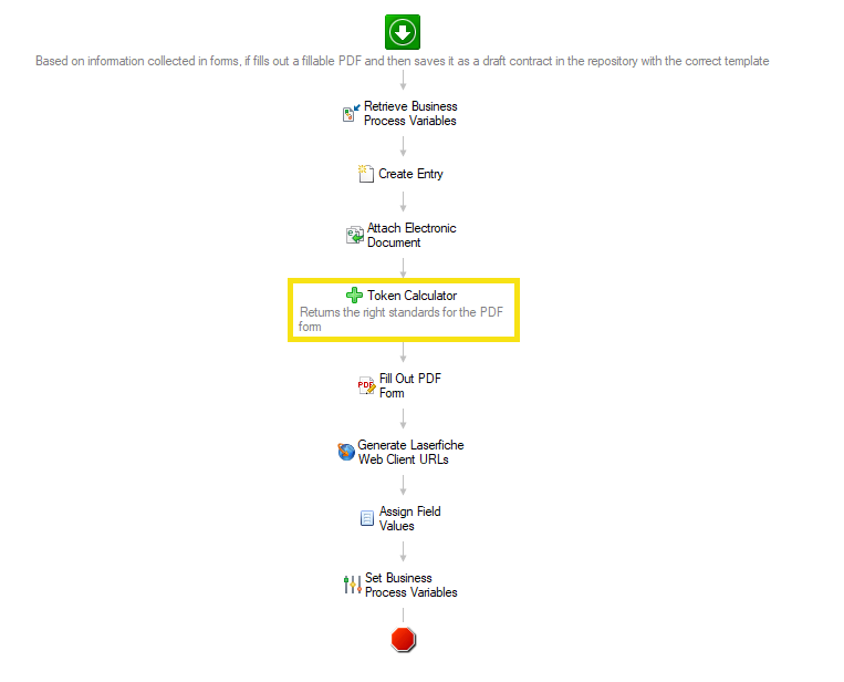

Here's my workflow (the Token calculator is not working)
