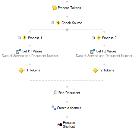

I've done things this way for reusable workflows. Basically, my workflow is set up like this:
  1. Create "Process Tokens" for the different values I need to act upon
  2. Conditional decision that checks the %(BP Name) token
  3. Assign values to my "Process Tokens"
  4. Perform workflow actions based on the process tokens
By creating the tokens, I only need the branch to handle retrieving the business process variables and assigning the values.
Since I assign everything to those tokens, I can use them throughout the entire workflow and reuse all my activities regardless of the original source.
replied on February 11, 2021
Hi Jason,
Thank you for your insight and diagram snapshot. It really helped. Using process tokens to designate which fields to pull from the different Forms process was something I hadn't thought of. It makes sense to be able to use the same workflow but designate different form variables throughout.

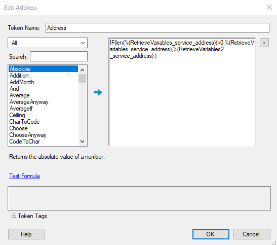

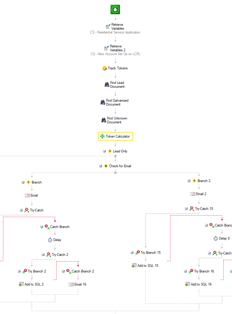

I ran across this and wanted to share how I have done this.  I just bring in the variables from the multiple processes then use a token calculator to set the variables to use in the workflow.  For the decision points, the variables can either be set in the token calculator, or you can just add the variable groups such as if variable_dataset_1=X OR variable_dataset_2=X.
I just look at the length of the variable to determine which to use.
