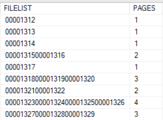

I have a field in a SQL table that lists the filenames of documents, but if there are multiple pages in the doc then it runs the filenames together like this:
I'm trying to figure out a way to take documents where the pages are greater than one and split the FILELIST value into the separate filenames.  They're all 8 characters long so I'm sure there's a simple regex or something I can do, but I've never been very good at it.  I can use \d{8} to capture the first set of eight, but I don't know how to capture every set and split them up.
I've also got scenarios like this where sometimes it has the filepath; I tested out using the same "\d{8}" and it matches the eight digit names I need, but again I don't know how to assign the different sets to the token

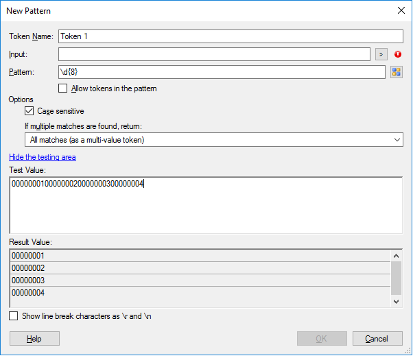

replied on February 11, 2021
I would just go with Pattern Matching instead of the Repeat loop, it's faster.
Dennis, note the change under "if multiple matches are found". The default is "first match", so that is why you were only getting one. If you change it to "all values as a multi-value token", you'll get all matches as individual values.

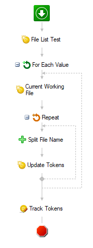

It looks like this in Workflow:

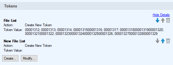

Here's what "File List Test" looks like (both multi-value tokens):
The "For Each Value" activity works on the %(File List) token.

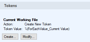

Here's what "Current Working File" looks like:

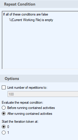

Here's what the "Repeat" Activity looks like:
Here's what "Split File Name" looks like:
Here's what "Update Tokens" looks like:
"Track Tokens" is set to work on the %(New File List) Token.

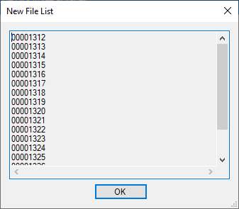

After running it, "Track Tokens" reports that the %(New File List) Token looks like this:
3 0
replied on February 11, 2021 • Show version history
I completely forgot that the Pattern Matching activity existed!  🤦‍♂️
The regular Assign Token Values activity has no way to convert the object into a multi-value token, but the Pattern Matching activity totally does.  I feel so sheepish that I missed that.
Oh yeah, that looks like a good solution Miruna - thanks!
And thanks for the script info Matthew, this is one of my first workflows from scratch so it's interesting to see how many ways you can skin a cat!
